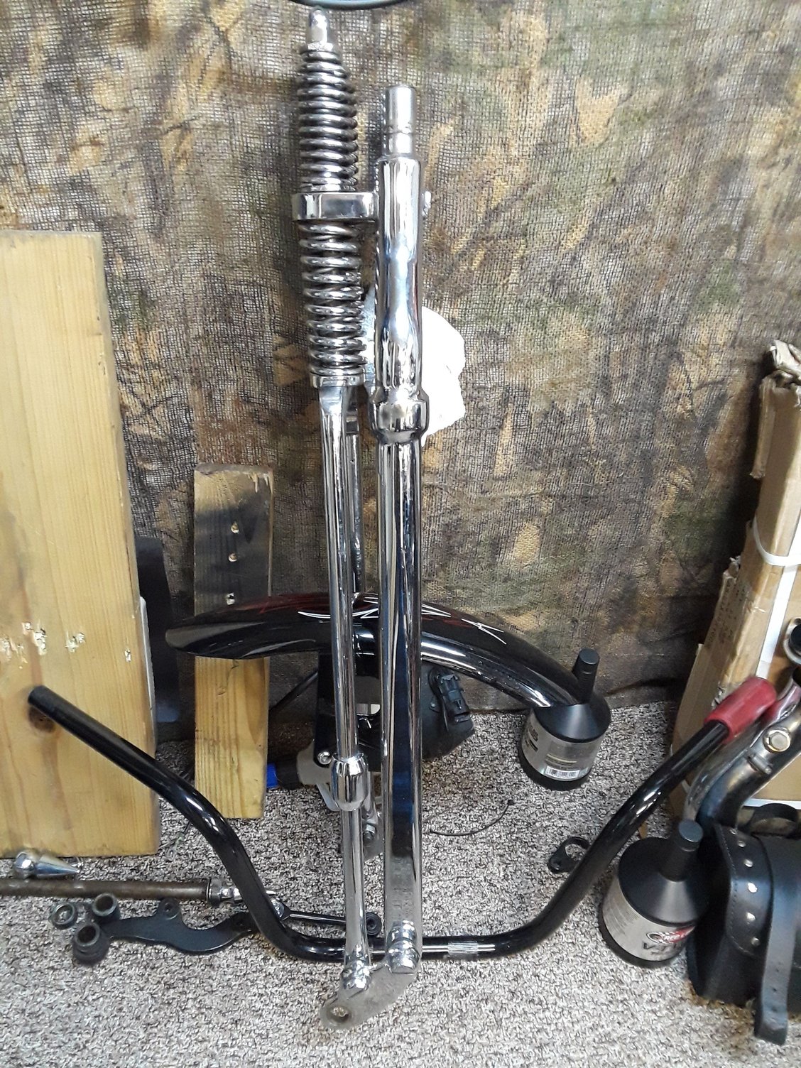

the whole fork setup from the side please.

Default Over looking the obvious
My humble apologizes upon further investigation and didn't realize it till spalt asked me for the part # that what was suppose to be stock turned out to be 3" over, so in order to do what needs to be done I am going to have to order shorter springs. know anybody that's looking for 3" over bottom springs 6 miles on them still doesn't excuse the springs being loose though. Once again thank you for your patience.
