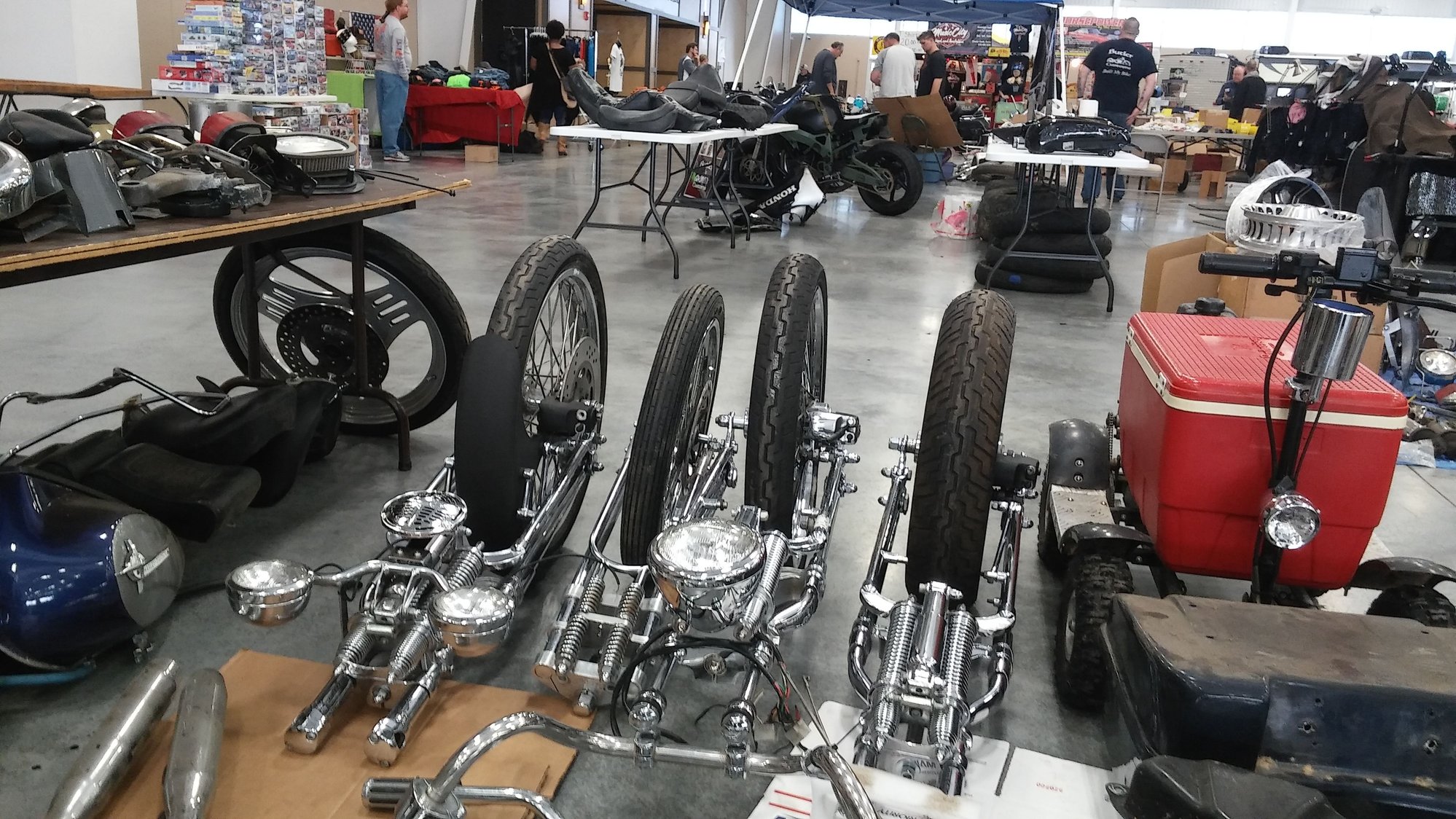

Originally Posted by splattttttt
those are probably all stolen
Really? I built them all from parts off ebay..that I bought before the prices got crazy. I plan to go to that swap meet this year with 3 more.

Sorry Tom. You just posted a random image. Thought maybe it was from aswap meet, where you ever know where **** comes from.
my apologies.
Tom those are yours ? I like those they look old school.
Yeah... 3 of them are Harley...I have sold 2...I still have another FX to build, and I picked up a complete crossbones front end.
