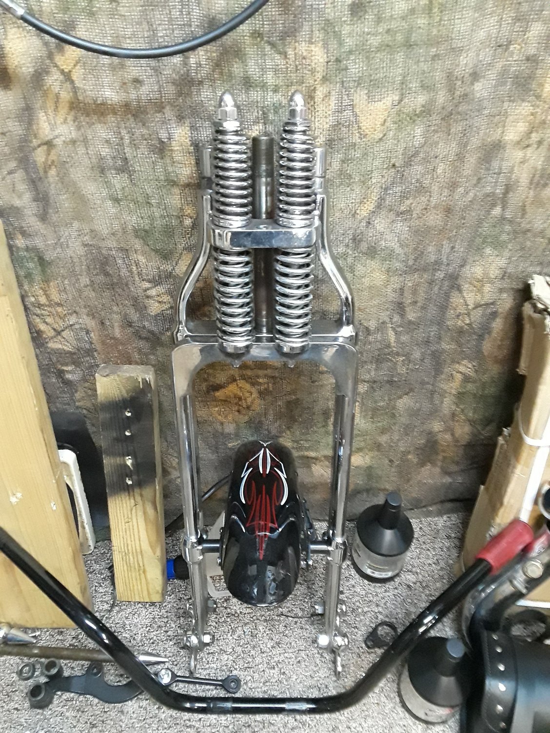

If you can move the bottom springs with the front end on the ground, you have something very wrong. Also, if you mounted your fender to the bolt that holds the rod to the springer, you're gonna have problems. If you hit a hard bump the tire will hit the fender if it is too close. You need to have someone that KNOWS springers look at that thing before you hurt yourself.
This is the springer off my bobber. It is a Paughco also. I have it off changing the neck bearings and rocker bushings.
You can NOT move those springs, top or bottom by hand. Something is amiss on yours I fear.

Thanks, Now I have a good picture of a proper set up and I think I got it some what figured out, your bottom springs look uniform, mine look like they threw them in and put a nut on. is it possible to get a side picture of the set up.Thanks

Likes: 3,770
From: Monticello, Florida
Side pic of what? The springs?
Also, post a pic of the shock mount. I think I'm seeing something not quite right but need a better view of the top and bottom mount of the shock.
