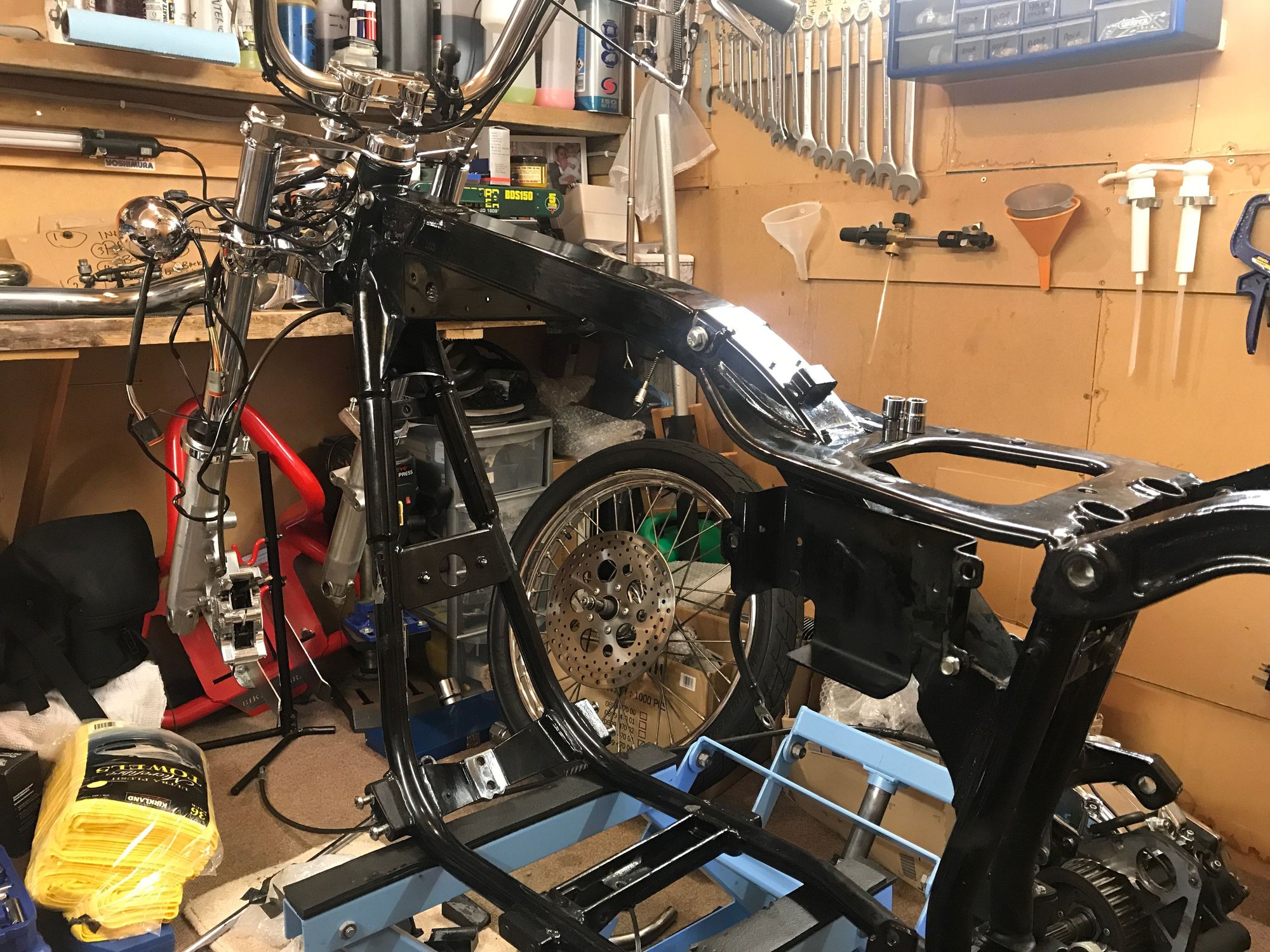

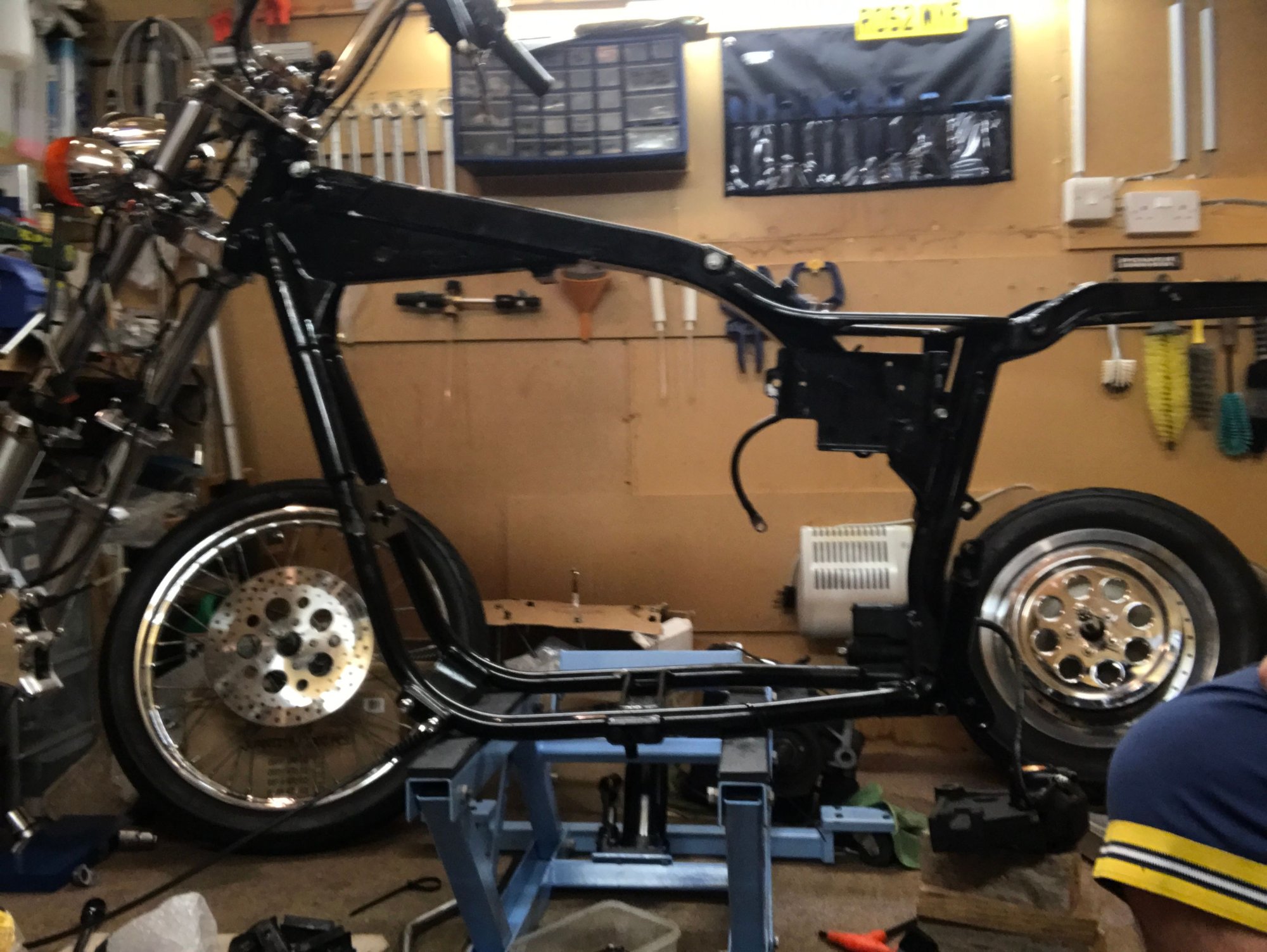

Hey guys just thought id update anyone who maybe interested or who was following this thread from the begging..
Bike is 99% stripped now, pulled the loom this morning , not gonna lie the thought of putting everything back together is a scary one lol, well making it work anyways haha...
Frame is gonna get Re-powder coated, the fenders and tank will be touched up, and general things that need replacing like bearings in the swingarm or silly things like waterproof seals on electrical connectors, and new nuts and caps etc...
back in 2000 the bike won a trophy for best bike in show here in the u.k so id love to get her back to that condition.. got plenty of time whilst i save the nearly £7k for a s&s motor..

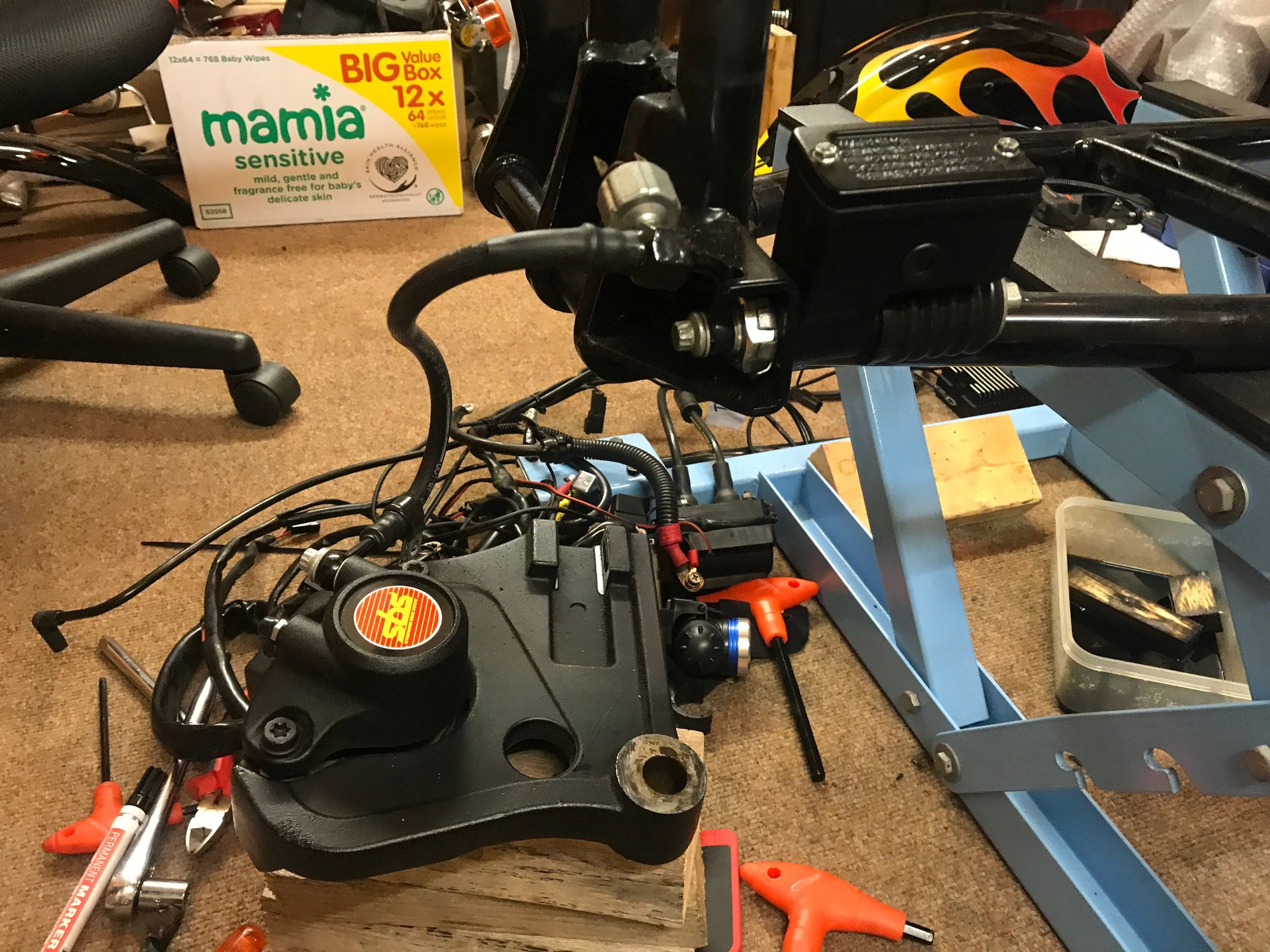

only thing left to do is remove the forks and bars etc and remove rear caliper... which brings me to a question... Can i remove rear caliper and master cylinder without loosing / spilling any fluid??
Daz

answer no it has to be un done at the master - plus you should drain and replace the fluid every couple years to keep the system clean and fresh

ok thanks for this,
best way of draining fluid now that i have removed rear wheel? Just pull the banjo and catch in a container?
Daz
