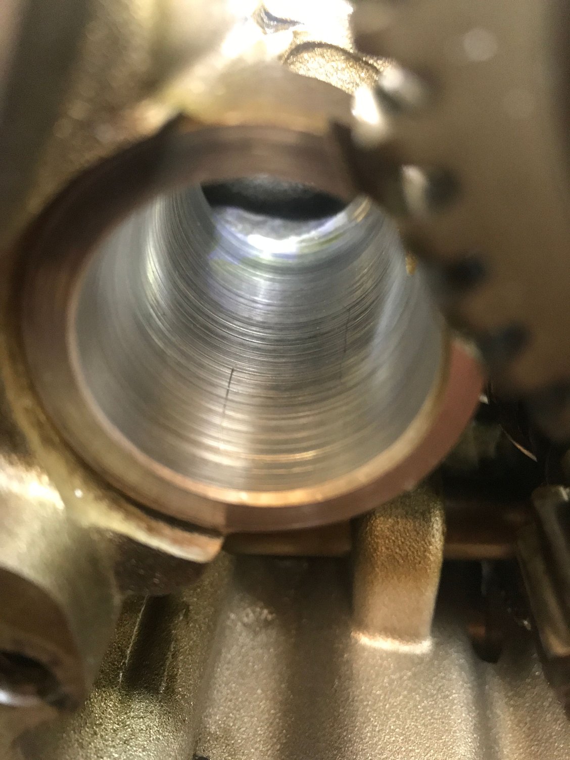

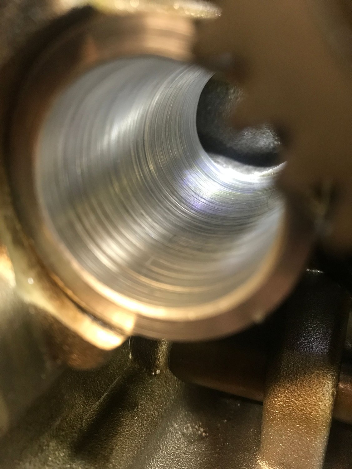

kingglide I pulled the plastic breather and here are the pics. Looked a little scored to me? I ran my finger inside the bore and you could feel the scoring but it wasn’t deep?

You found your missing aluminum bits.
That bore should be smooth as silk...like a piston cylinder bore.
The plastic breather has dug it all to pieces.
You can get away with a few mars and scratches, but I would say you need that sleeved.
That is a good example of what a bad idea that plastic breather is,/was.
It is beyond shot and should have been tossed years ago.
Sorry man...
Now at least you know.

oh wow, really??
Map did this cause my oil pump to die also??
what causes the plastic to do this? You sound like you have encountered this before lol. ?

This is a common problem with plastic breathers and yours is the worse I have ever seen.
They collect metal bits like I described earlier and continually spin the debris in the bore.
Yes, you want the metal one as you posted.
Albeit I am not sure how well it will work with the bore all tore up.
I think this is is a good time to pull the engine dwn and check everything.
