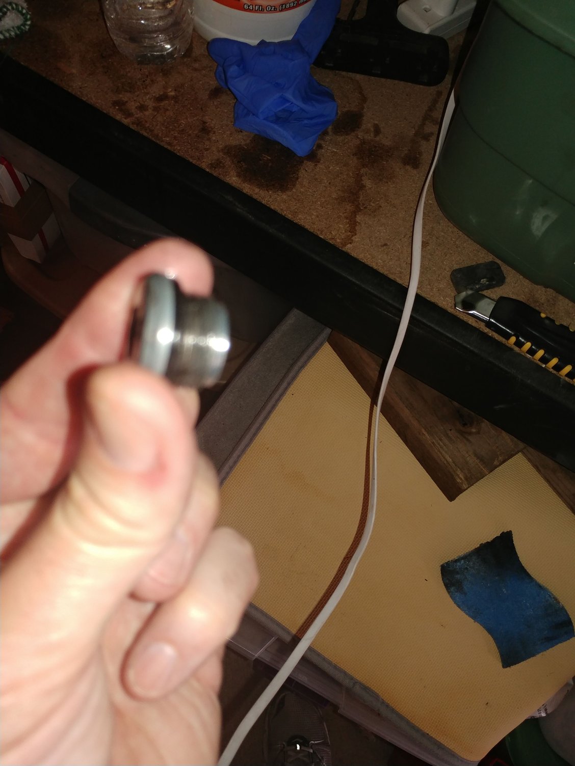

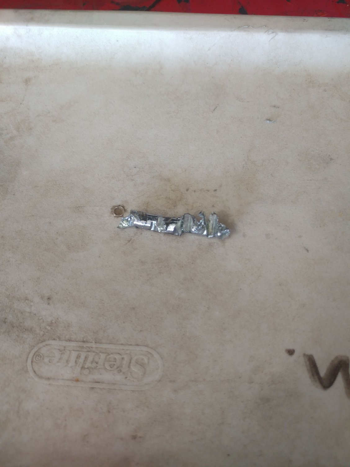

Mother ****ing trans dip stick broke off. WTF

Uh oh... I don't think gears like these
Have you got the cover off?

all the metal is in the door bearings

Luckily it was still in big pieces

Holy ****! Guess the engineers never took that into account on the design of it.
Warranty?
