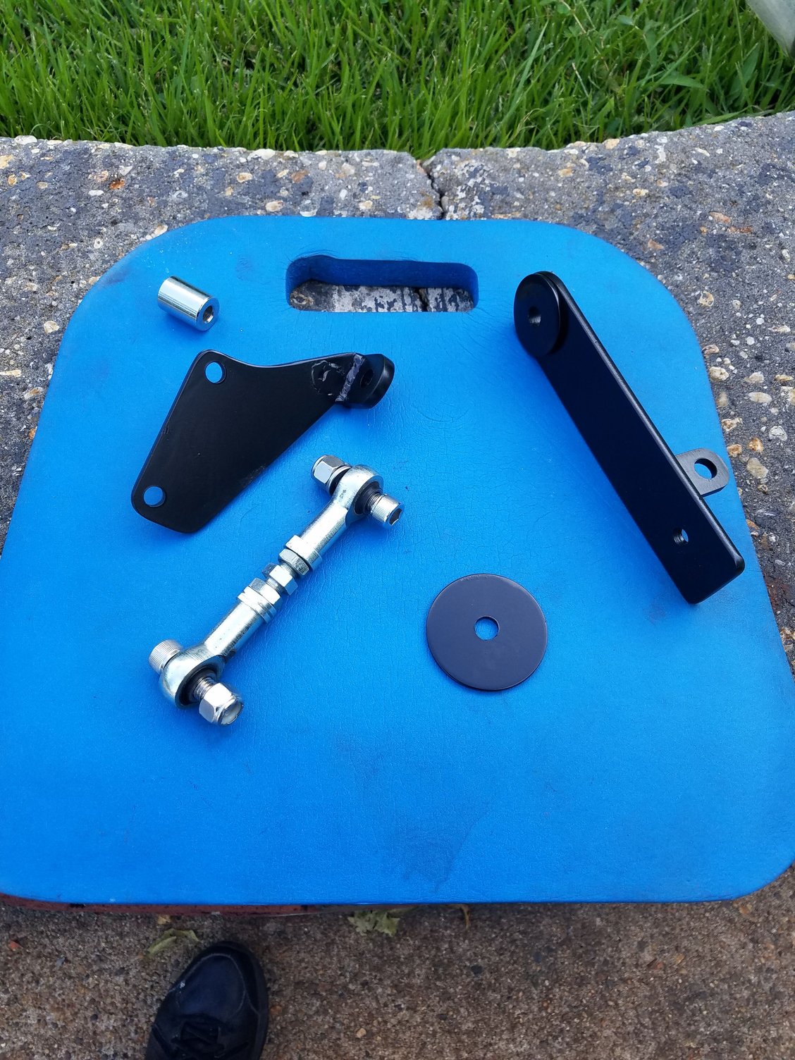

Old Aug 24, 2018 | 07:54 PM
bentparts's Avatar
bentparts
Joined: Apr 2009
Posts: 501
Likes: 150
From: Jersey
Default Finished parts

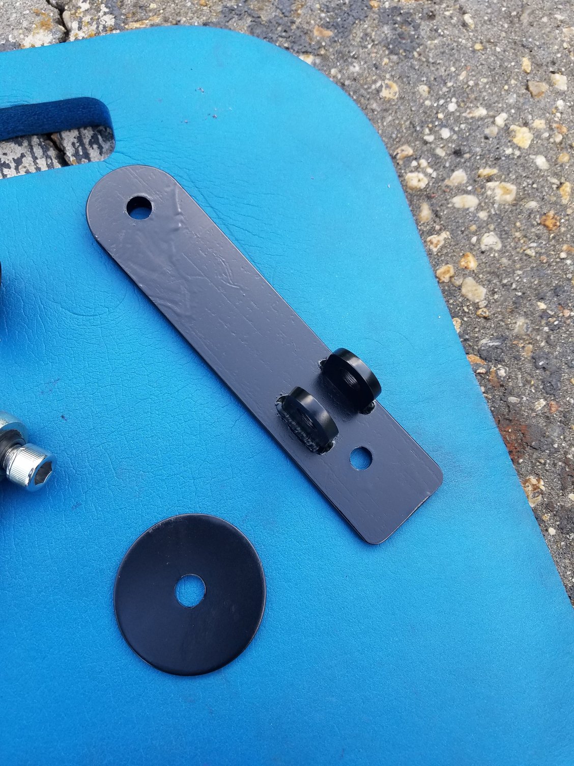

Not billet pretty, but fits perfect. The only thing I had to have made was the 1.5" puck that fits into the crossmember. Fortunately my buddy has a plaza table and burnt me a few in about 30 seconds.
Simple and strong. Everything is made from 3/16 plate and bar, and the only thing I bought were the two SS bolt and lock nut sets. Had an old Heim from my bike laying around. Total cost including consumables was about $20, few hours work. Mounted it up in about 1/2 hour. Now I just have to relocate the catch bottle for my engine and trans and put the exhaust system back on.
I just rattle canned a coat of paint on them, runs and all, just to protect them, this winter I'll have everything powder coated. Test ride tomorrow yea!

Old Aug 26, 2018 | 06:01 PM
bentparts's Avatar
bentparts
Joined: Apr 2009
Posts: 501
Likes: 150
From: Jersey
After 2 days of riding I can honestly say WHAT A DIFFERENCE! Even straight line stability is hugely improved. Sweepers, ramps, twisties, bike now feels like a single unit rather a composite with a hinge in the middle. No more shaking it's *** like a stripper looking for a buck. Where they're repaving I 295 and the pavement is all stripped even the grooved pavement doesn't' faze it. Worth the effort absolutly.
