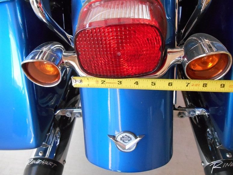

Simon,
Are you sure on the measurements? Here is a Photo of the turn signal bar on my 05 FLHRS. I measure 5 3/4"center to center for the mounting holes. Note that the holes are at an angle. See attached photos. Note:The signal bar us photographed showing the bottom of the bar. It would mount 180 deg. from photo.
