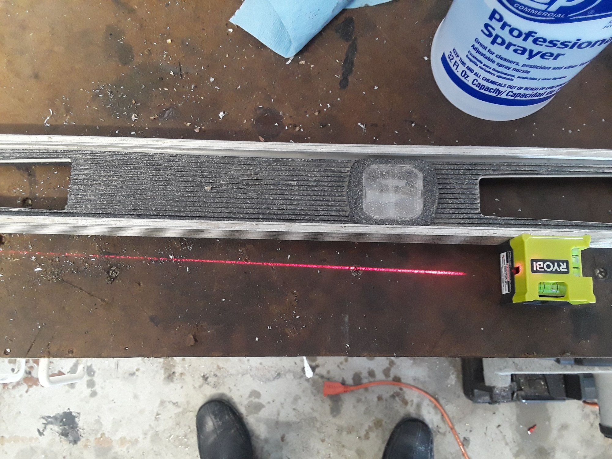

Originally Posted by 0maha
One thing I discovered the first time I did this is that the cheap line lasers are not square to their bodies. I squared them up by shimming one side (on the corner, that is) with a few layers of tape.
Can see where that could make for some disappointment if not caught.
I'm thinking your straight edge is crooked, the laser is square to your feet, try a different straight edge or move your left foot back
