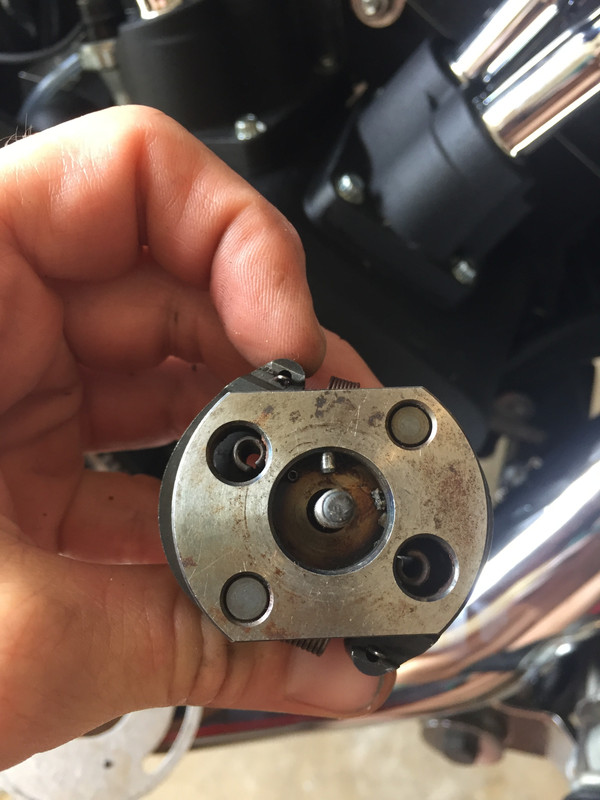

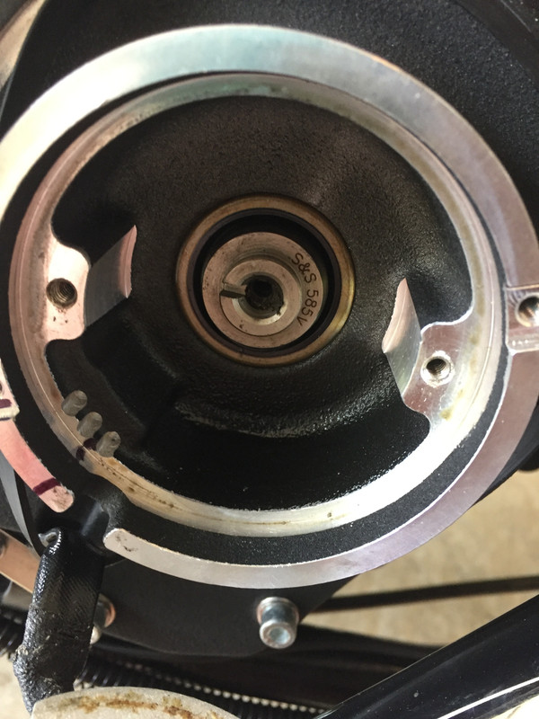

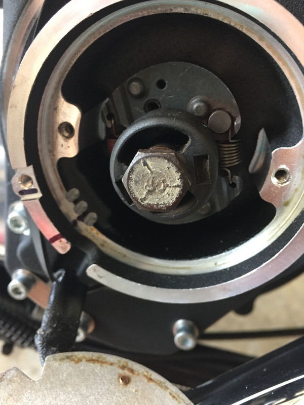

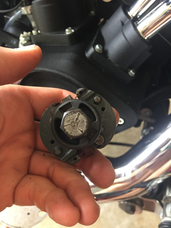

I tore into a couple of things.
The fuel line was new when I changed the motor. It still does it no matter where I route the line. The mechanical advance looks good and moves free.
The cam seal is leaking a little. Will eventually have to change that out. All of the wires coming from the ignition module are intact and good.

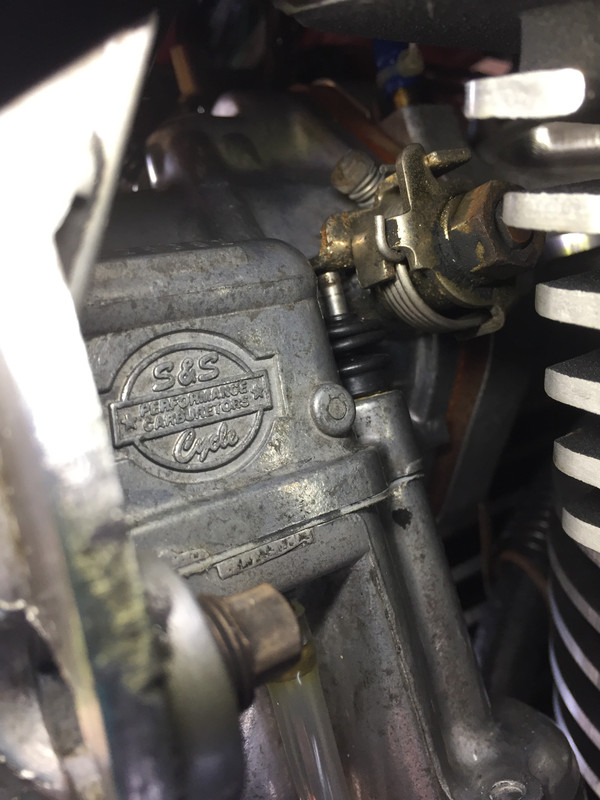

Texas.... that little black boot on the plunger looks like this when I took the picture. I can't remember from memory if it's supposed to be all the way up or not. That could be a possibility.

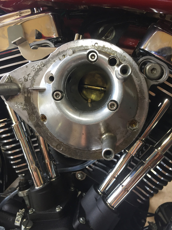

The butterfly on the carb is nice and tight and not loose.
I don't have time to check the petcock screen or tanks. There could be some crap in there. I would also like to run a compression test on the motor when I take the tanks off to check them for debris. But I'll have to unplug the acrs. Can anybody think of anything else or see anything that jumps out at you?
When I was having my stalling problem that little boot had dry rotted in several places.
I couldn't see it until I removed the boot.
After I replaced it my stalling problems went away.
