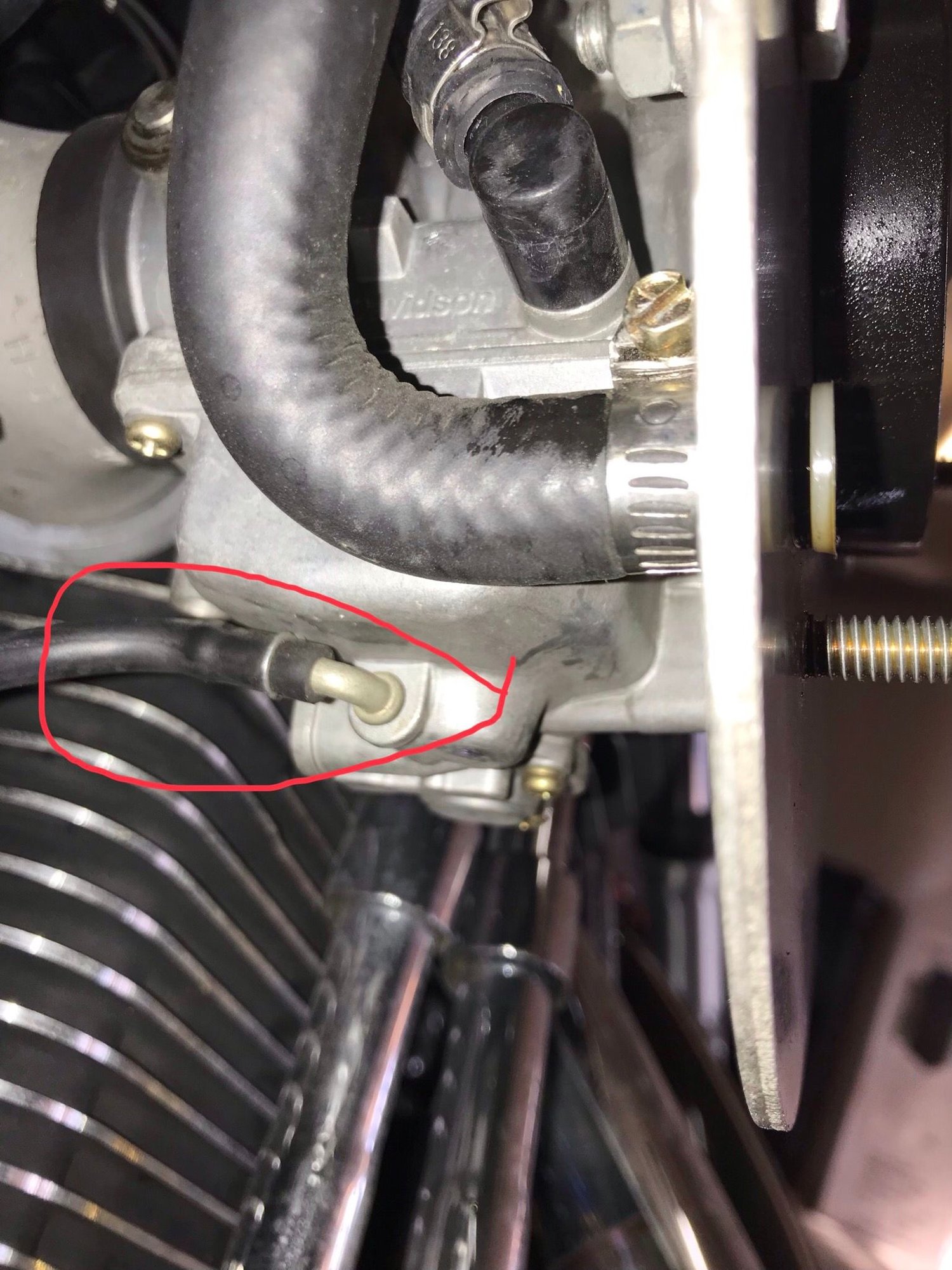

’98 Dyna.
I found a small diameter hose exiting from the bottom of the CV carb.
It just ended in the air down by the oil pump.
Shoul it be connected somewhere?

That's the overflow.
Doesn't connect to anything. Just make sure it's routed clear of the exhaust and you're golden.

Consider yourself lucky you have one. The latter CV carbs have been neutered by the EPA and they pulled this feature.
