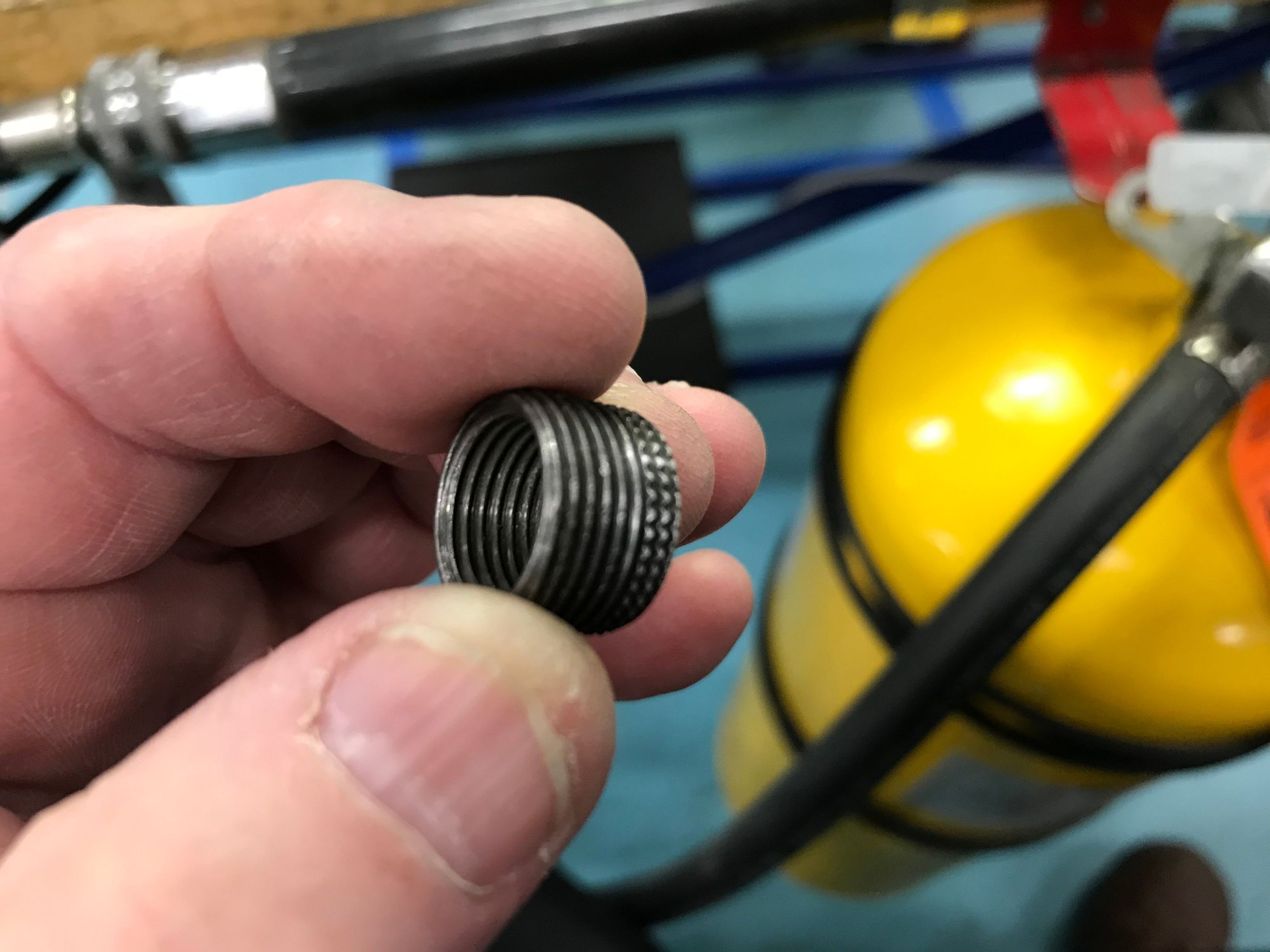

I’ve repaired a lot of shovelheads with these.
No evo.
I tried a heli-coil , years back but didn’t last long.
Good luck.
Ride Safe,
Harold
No evo.
Good luck.
Ride Safe,
Harold
That is the similiar style I used on the triumph. The strike in place tool expands the top portion that you see with the teeth. The teeth bite into the aluminum to hold it in place. YD

Thanks Harold, and everyone else.
Looks like what you pictured is the most popular so far. The Master Tech at the dealer here (he's a good guy) said he uses Heli-coil wire type. I've used them for a lot of other things over the years and always had good results.
I ordered the Time-Sert kit Tuesday. Figured I'd not be totally satisfied otherwise, though any and all types mentioned on here may have worked just as well. The heads are off due to unexpected other issues so it should be an easy operation.

Good call on using a barrel insert. Helical inserts are famous for peeling out on spark plug repairs though they seem to work much better on cast iron heads rather than motorcycle or other alloy heads. Many good mechanics fail to study broadly and update their knowledge. If in doubt, copy aviation. Beware of anecdotes since individual mechanics might have seen a high success rate not representative of the industry. You of course are free to study widely and outside mere motorbike circles.
