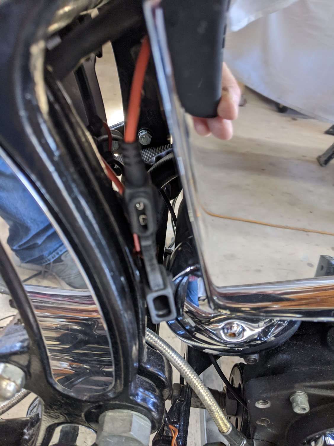

I read the Sticky on "The dreaded click". This is what my eyeballs transferred to my brain.
I pull the red/black wire, female blade and all out of the connector for #30, tape it off.
Run a 20 amp fused, heavier gauge wire from my positive battery to the #30 connector complete with a new female blade
A cleaner install would be to run the wire to the silver stud of the main breaker, the less connections you have at a battery terminal the better.
The female blades the MOCO uses have a small keeper to hold them into the connector housing.
If I were you I'd either cut the red/black wire and slice into it (don't forget to put a bit of heat shrink on the harness side) or buy a new connector from the dealership.
While you can use a regular connector you have to use zip ties to keep it in place.
This is what I did the first time.
Now I use connectors I got at the dealership.
While I agree with Dan that it would be a cleaner look going to the breaker I just wire mine to the battery because it's much easier and I haven't had any problems doing it that way.

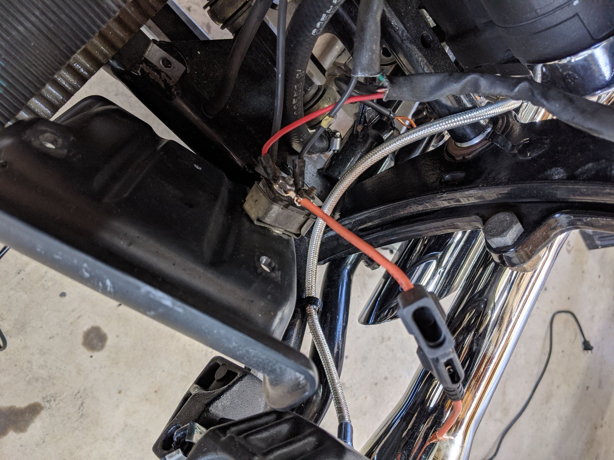

Since the back tire is off I went ahead and put the fused wire to the main breaker.
Cut about 3" away from the connector, did the crimp/heat shrink. Ran the wire straight down to the main and the fuse has easy access.
I also stuck a small screwdriver in the female tabs in the connector to bend them tighter, plus a shot of electric cleaner for ***** and giggles.
Tested it a few times, works like a charm.
