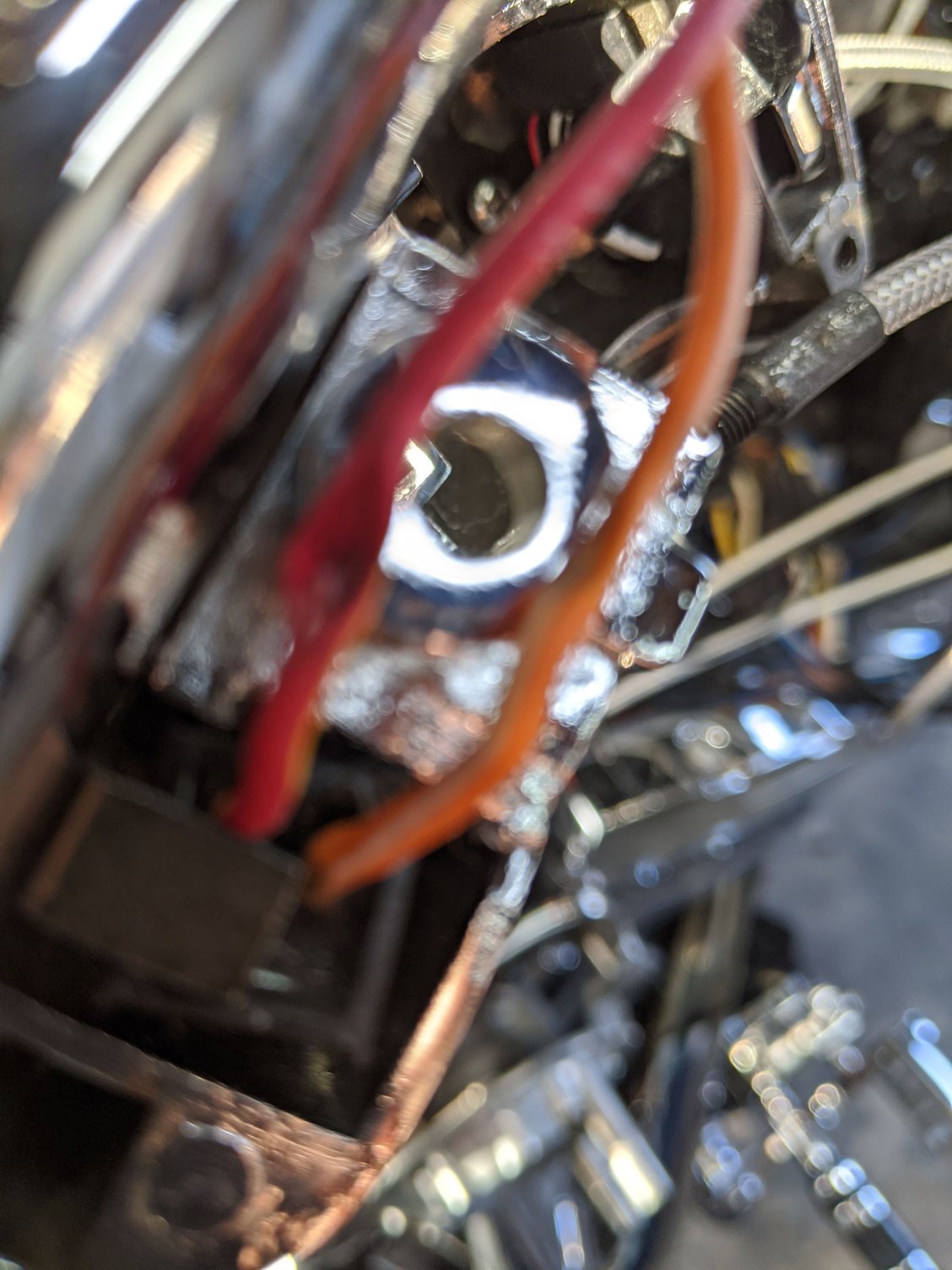

This weekend I'll repair my screw up and post a pic.
After I'm all in on liking what I have on my electrical, I'll tackle the mess the PO made on the back side. Clean that **** up like a shiny penny.

Originally Posted by almostakeeper
Hooked the ground back up on the battery and everything is back to serenity.
I had two pinched wires at the right switchpak.

Originally Posted by TSheff
Yep - That would do it and explain NO START. Good deal.
So Very common there should be a Sticky in everyone's Shop... Handlebar wiring and switch assembly, should Take Twice as Long, as most spend at it!!!!

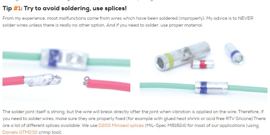

Just out of curiosity why did you use crimp fittings instead of solder?
I am not sure why so many people think solder is better...solder makes the wire brittle next to solder joint, and in cases of high vibration...like a solid mounted Harley motor... can break...
If you used high quality crimp connectors, and a good crimper it is not possible to get the wires apart...if you use the $10 connector kit from Autozone...you get what you pay for...
Many of the quality connectors now come with shrink wrap made onto them...all factory wiring harnesses use crimp connectors....

https://www.kmpdrivetrain.com/genera...ing-harnesses/
I've heard that but I've got soldered joints on my Heritage that are at lest 10 years old.
No problems so far.
No problems so far.
10 years is not very long at all... My 1968 BSA still has stock Wiring!!!! and none of it is soldered...
Yes it is Lucas...and yes...It still works!!!!
being in Electronics in the Canoe Club...I was taught where solder is Used...and where it is Not!!!!
