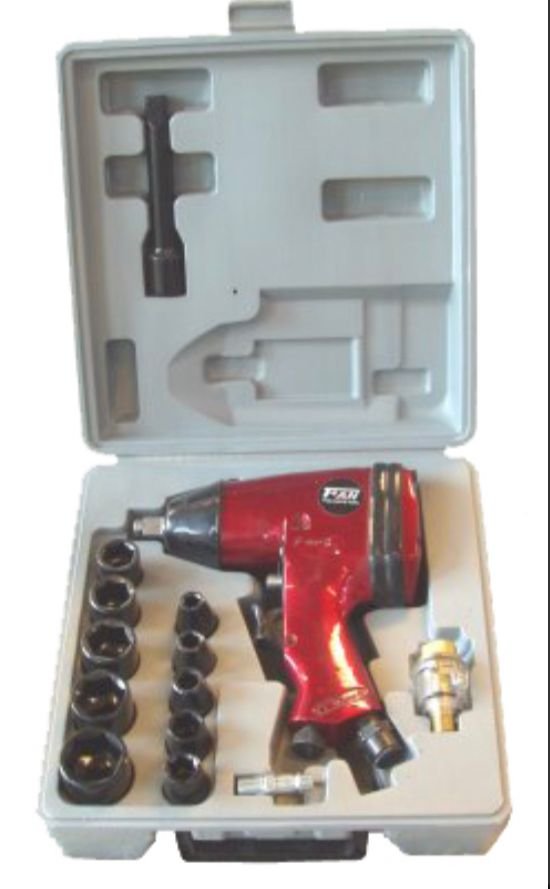

I have used one of these gadgets with good result.
Driven by compressed air.
My machine also have a ”hack-hack” mode.
(No idea what the correct word is, but I think You guys know what I mean).
Those sockets won't work on that particular nut.
But there are other sockets that will work no?
Sockets that will fit on the air-tool?
