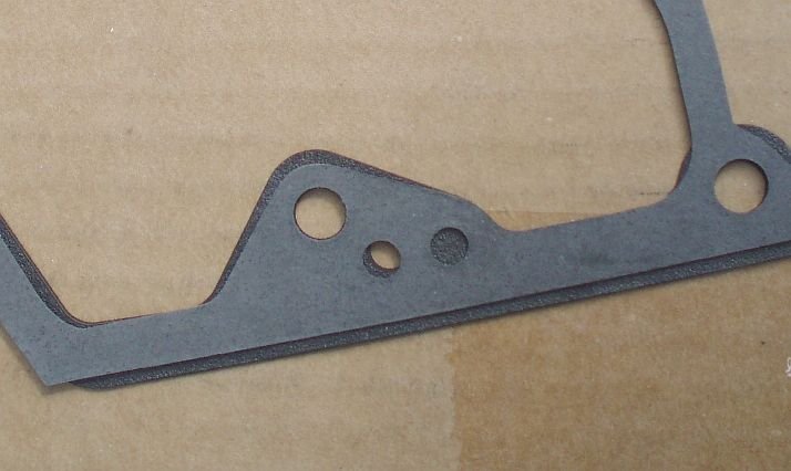

Just like rockers, tappet guides, replacement cylinders, rods etc., OEM cam covers are line reamed and honed on a jig at the factory - direct bolt-on, no sizing or modifications necessary. Drag Specialties premium covers are pre-reamed also. The el cheapo ones are not sized.
The timing cover in the video looks chrome to me. Is this a video of before you swapped out the covers?
Black foamette gasket on the bottom is aftermarket (mfg unknown) for a top breather. Fiber gasket is OEM for bottom breather.
