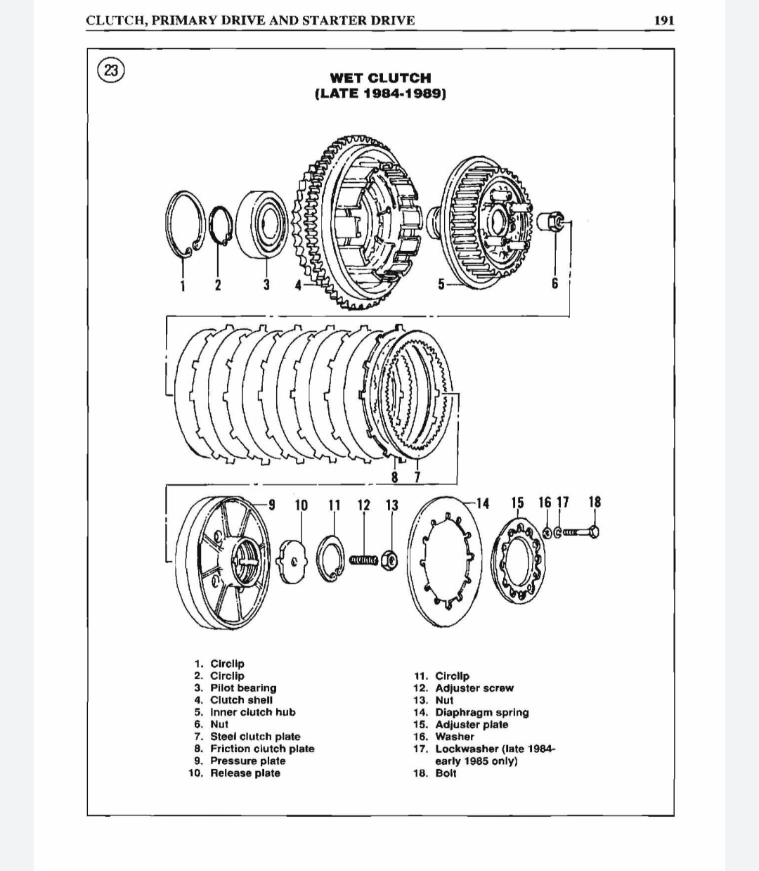

The transmission nut is reverse thread.
If you find that it came loose it needs 2 drops of blue loctite when reinstalling. Let the loctite cure for 24 hours. I found that out the hard way.

#6 on your diagram
