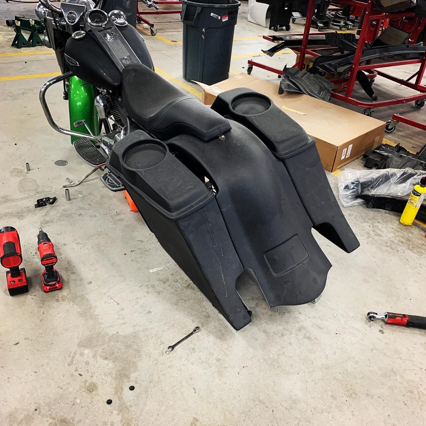

Got the rear end parts and new seat rough fitted. Had to do a little chop here and weld there but it’s on. Found the primary leak. It’s actually a trans leak running out between inner primary and trans. Bunch of parts from ronnies HD on the way
First thing to check is if the inner primary bearing race walked into the trans main seal.
thanks. I’m planning on doing all that and the bearing while I’m in there
