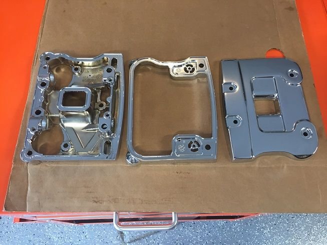

Well, the dealer said it might take several weeks for the new rocker boxes to come in, it took 4 days .
Shiny new made in USA rocker boxes.
