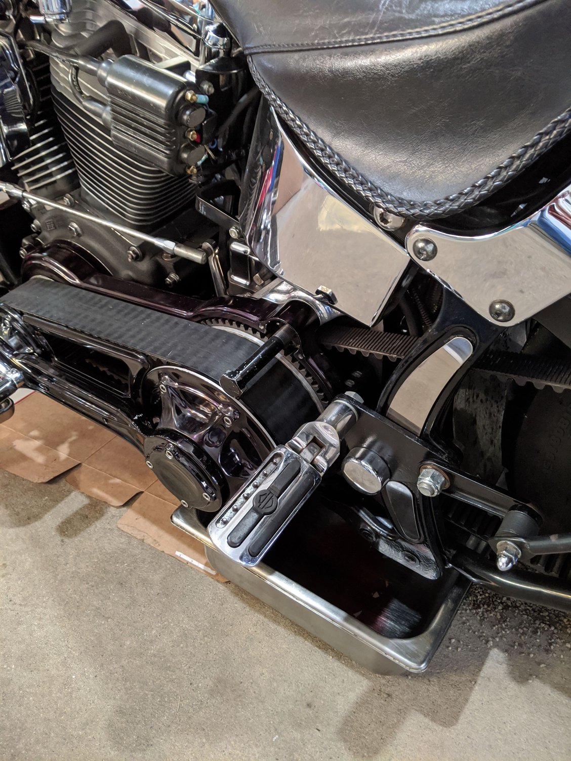

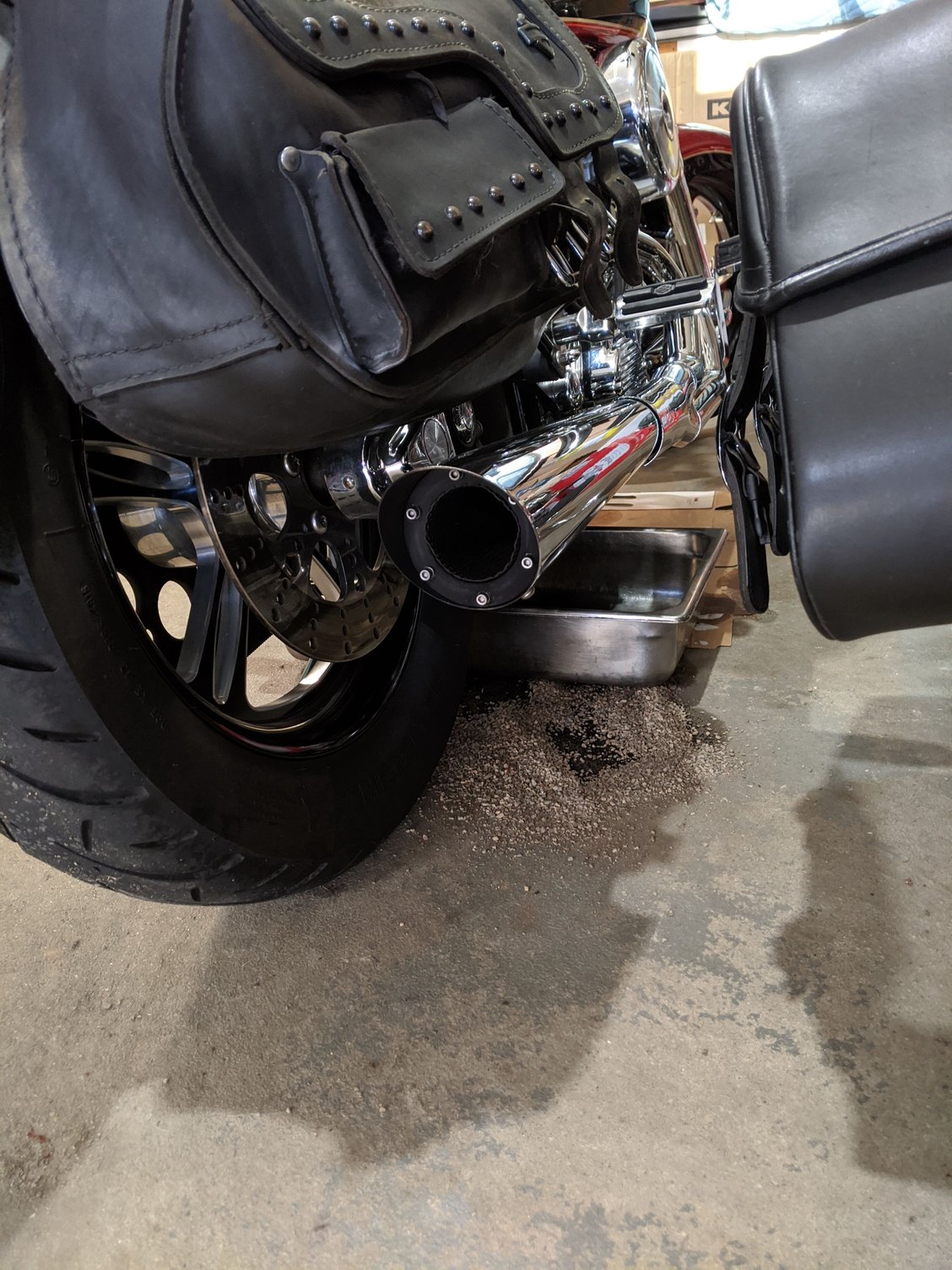

Went out to the garage yesterday morning only to find tranny fluid on the floor.. So I put down some speedy dry and then a pan under it... I don't think it's the 5th gear seal. They usually only leak a little.. This one has been leaking for a couple of days now and appears to be above the shock.... Hopefully I'll get into it Sunday..

I took another quick look under the trans and cannot see any physical leaks.. Nothing on the trap door side and nothing on the drive gear side as well as the top cover gasket. It's definitely coming from the bottom of the trans and leaking onto the shocks The largest drip I see is coming off of one of the stud mounts.. Has anyone ever seen fluid loss through any of the mounting in the bottom of the trans case...? Definitely looks like the trans is coming out for a closer inspection.. It's the only way I can see up in there but if anybody has any ideas or even past history of something like this occurring to the bottom of the case, I'd appreciate it.. Thanks... One more thing, there was never any odd noises, vibrations nothing... The trans still shifts perfectly... No problems mechanically...
Paragraphs are your friend!!!!!!
That said LOL your gonna have to take it apart to see.
FWIW my Baker sheared 2 dogs and that ate up just about everything else including cracking the housing.
It shifted fine but that's about all that worked as normal when it grenaded.
