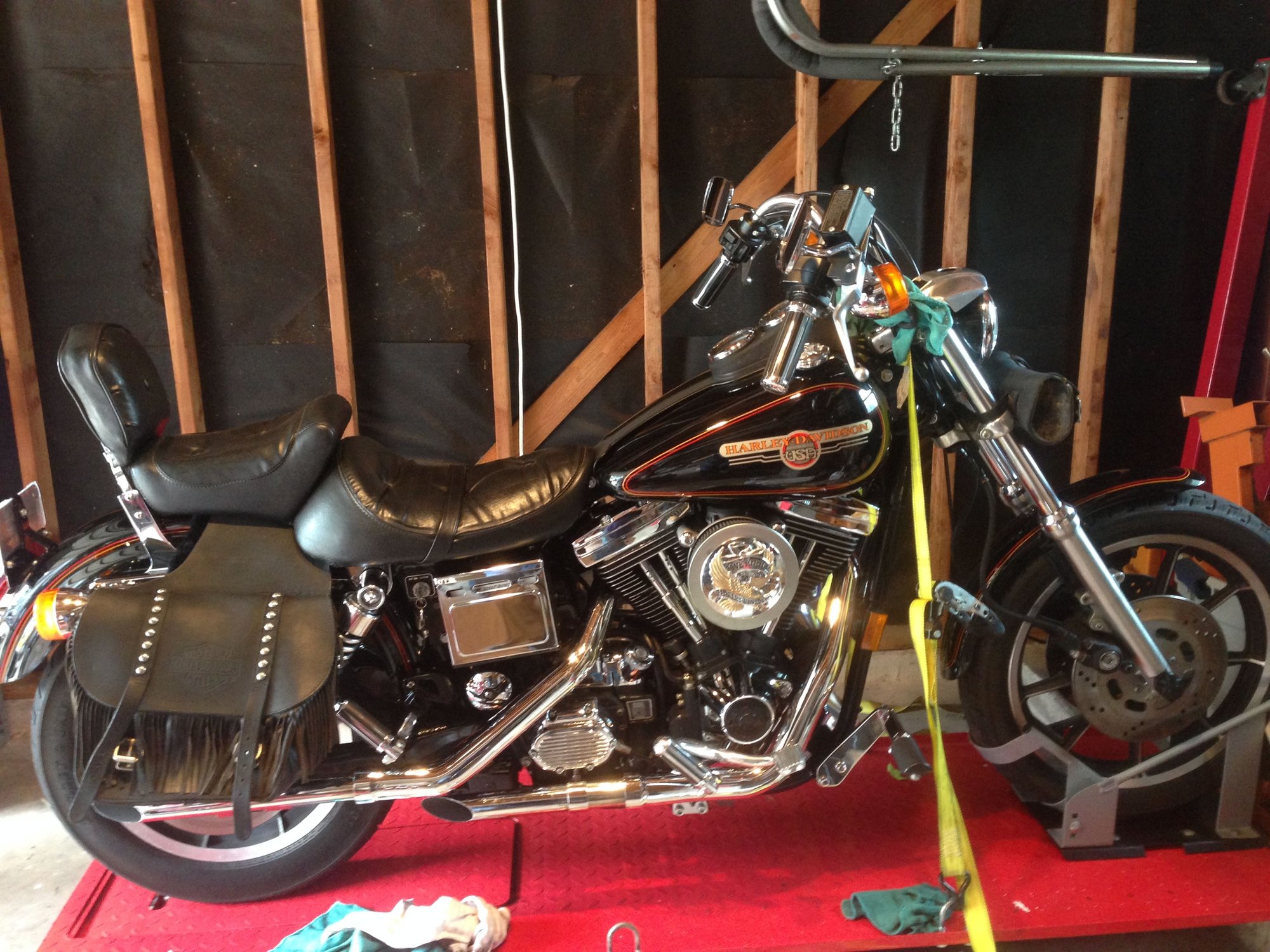

I finished putting the bike back together.. after a warm up and short ride I'm happy to report no oil leaks, however, the bike is running rough! The idle goes from 800 rpm down to 500 rpm then back up. At stop lights I had to open the throttle a little to maintain 1000 rpm. Before the teardown the bike idled consistently at 1000 rpm w/o opening the throttle. Also, I'm getting a hiccup at the carb / air filter especially riding at low rpm at low speed. I suspect it's an air leak at the intake manifold. What do y'all think? I replaced the HD spark plugs with Autolite 4265 (gap 0.40). Also, do I have the saddle bags orientated properly? I have the curved portion of the yoke
at the rear.

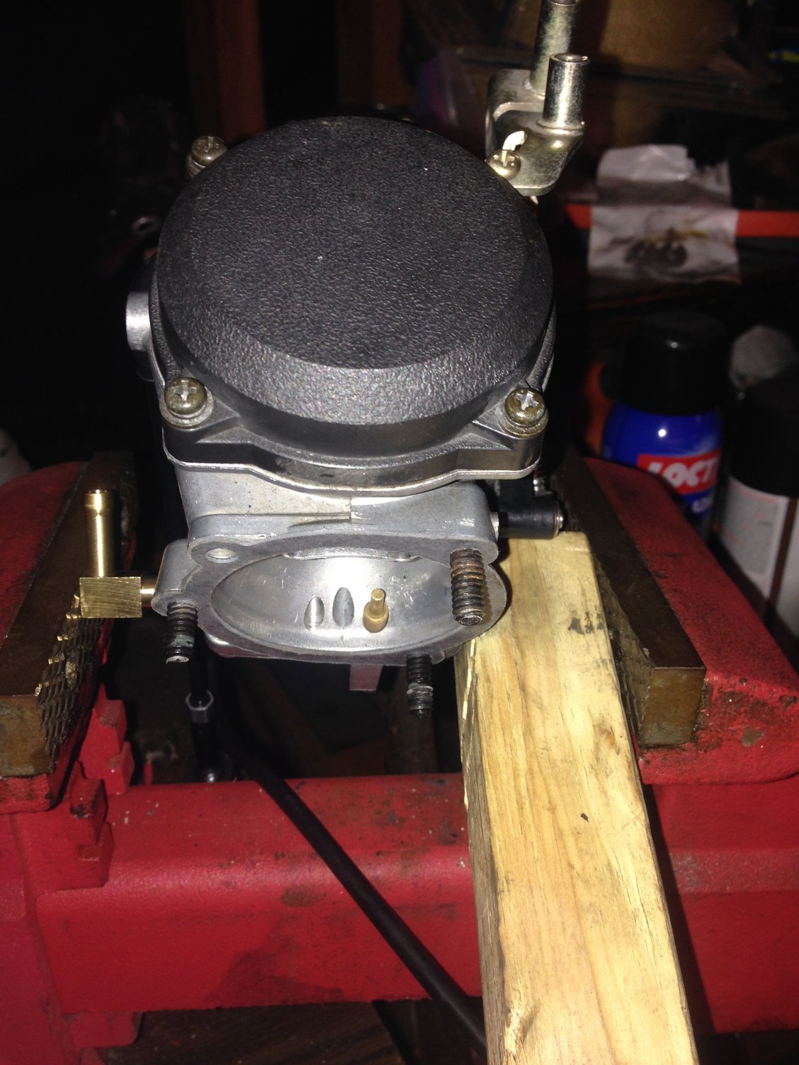

I took the carb off and re-aligned the intake manifold per this video which was instructive:
The bike is running pretty good! I also found a leak at the plastic inlet fitting to the carb so after researching I purchased HD part 27371-76A and pressed it in with a vise. CV Performance has a nice write up the procedure.

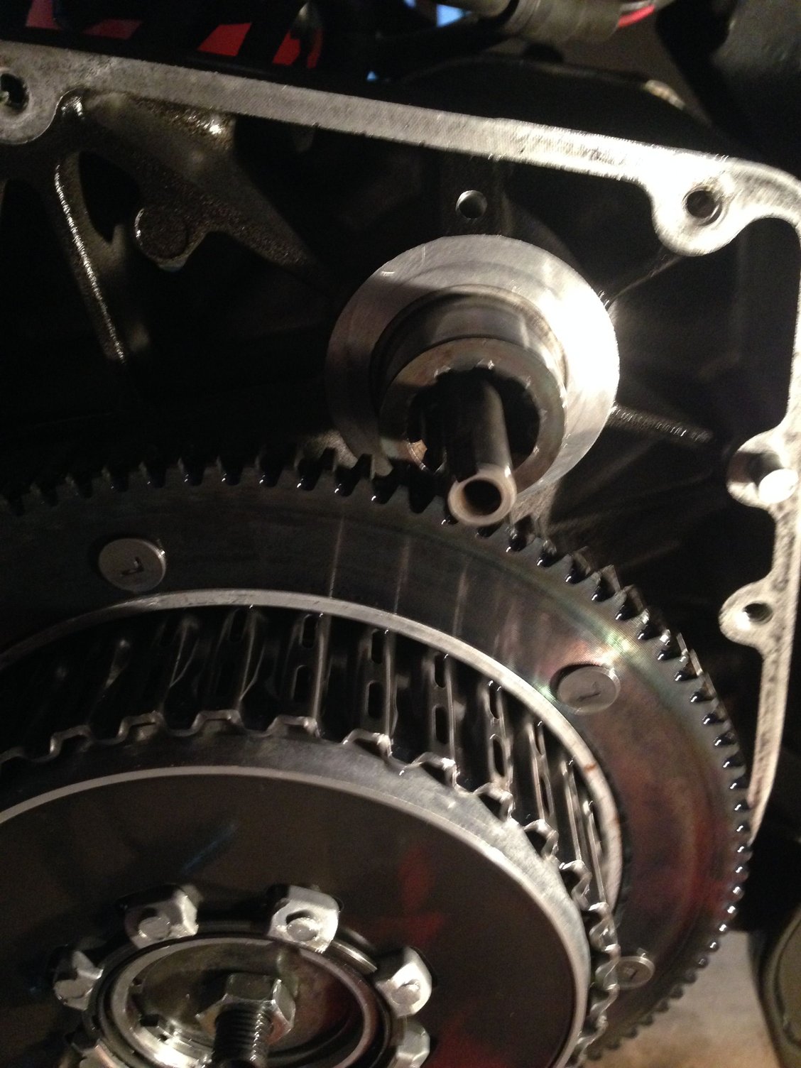

It looks like I found the reason why the bike wouldn't start! The jack shaft came out with the primary cover! I haven't found #6 (circlip)!
