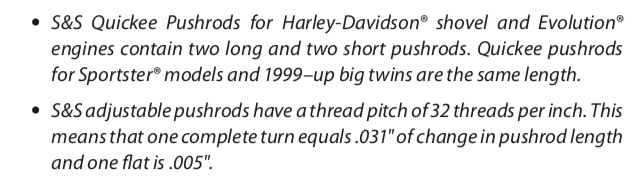

Old Nov 7, 2020 | 07:20 AM
  #32
johnnyjellybean's Avatar
johnnyjellybean
Joined: Jan 2013
Posts: 232
Likes: 11
From: montreal
Originally Posted by Adam76
Hey 98, just out of curiosity - when buying a set of EZ install PRs, are they all same length? because you adjust each one to fit accordingly anyway?
Or do some manufacturers of EZ install PRs still make the exhaust ones longer than the intakes ? (I didn't check mine for any differences in length)..
You got my curiosity going so I looked it up........From S&S website

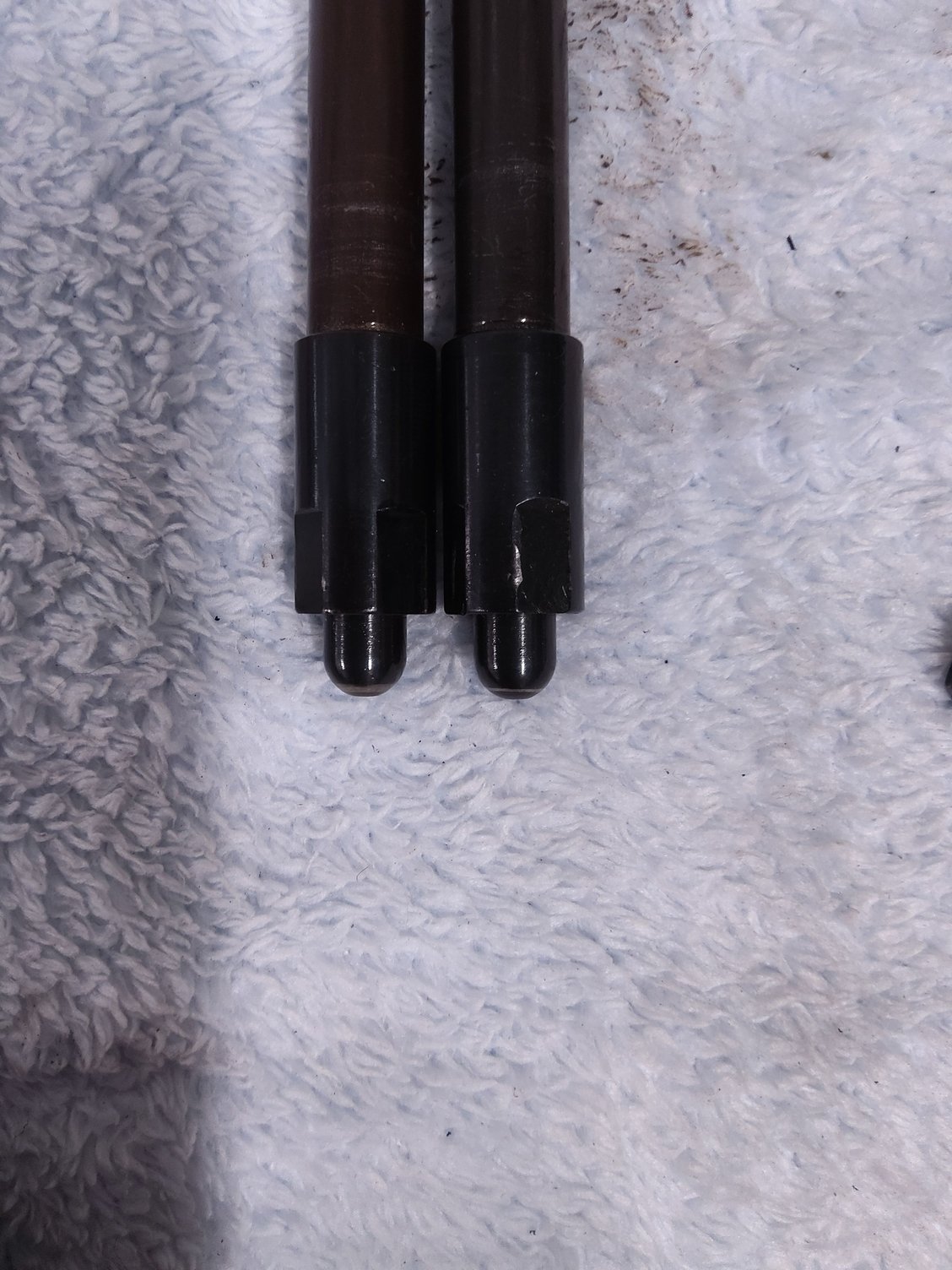

Old Nov 7, 2020 | 07:35 AM
  #33
Adam76's Avatar
Adam76
Joined: Apr 2017
Posts: 1,050
Likes: 92
From: out there
The adjustable pushrods are the same size before adjustment, but once they are in position and adjusted they will all be slightly different.
Mine aren't S&S quickees - they are an unmarked, all black color, 24 tpi ez install PRs that were already on the bike when I got it...
But I just realised that I never thought to check the adjustables for differences in length for incase there was a difference for intake vs exhaust, like evo s&s ones are...
Old Nov 7, 2020 | 08:28 AM
  #34
WP50's Avatar
WP50
Joined: Apr 2011
Posts: 6,185
Likes: 2,134
From: W. Texas
PRs that were already on the bike when I got it....
If you reused these and put them back in their original position (order)
Would think it would be good to go.
WP
Old Nov 7, 2020 | 10:08 AM
  #35
daven9113's Avatar
daven9113
Joined: Aug 2007
Posts: 942
Likes: 323
From: Grew up in Texas, moved to AZ
Adam76, looking at your first post pic, you have the same style EZ adjustable PRs as I do, and they are from Screaming Eagle. All are same length to start. I like them a lot. 1/2" on nut and upper, with 5/16" size flats on adjuster screw if I remember correctly.
Old Nov 7, 2020 | 10:40 AM
  #36
Jackie Paper's Avatar
Jackie Paper
Posts: 38,586
Likes: 6,435
From: Honah Lee

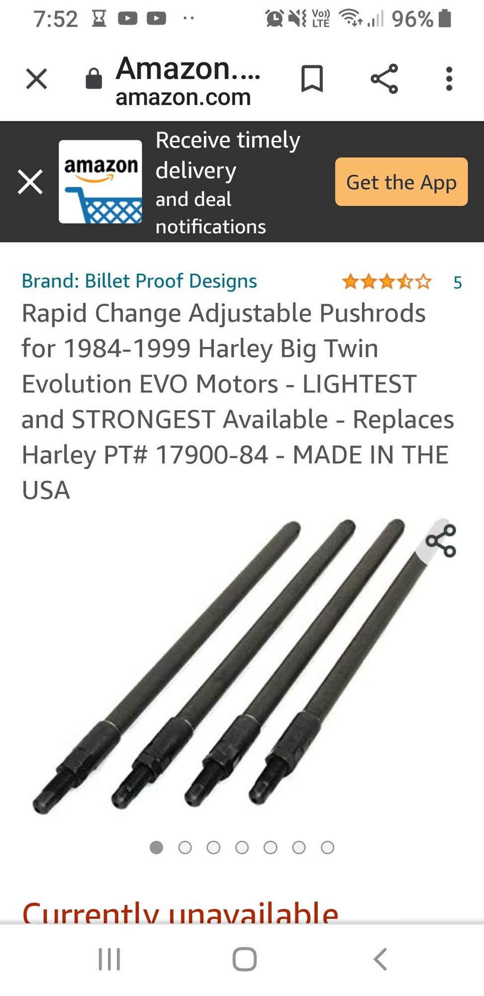

Old Nov 7, 2020 | 05:41 PM
  #37
Adam76's Avatar
Adam76
Joined: Apr 2017
Posts: 1,050
Likes: 92
From: out there
hi daven9113, Yes they are 5/16" on the threaded section and 1/2" on the upper adjustable section.
They aren't SE PRs, because SE ones have definite markings and a different style adjuster nut from what I can tell.
Looks like they are these ones, which I think I read have different lengths for intake vs exhaust.... Now I have to pull them out, measure them all and reinstall them correctly according to length 🙄
They could be these?
Old Nov 7, 2020 | 08:41 PM
  #38
98hotrodfatboy's Avatar
98hotrodfatboy
Posts: 21,115
Likes: 7,638
From: Poolville
No you don't have to pull them out. All you need to do is lift the tube covers and see if each one measures the same from the nut to the lifter If they do you know you got the right push rod in the right position...
Old Nov 7, 2020 | 11:05 PM
  #39
Adam76's Avatar
Adam76
Joined: Apr 2017
Posts: 1,050
Likes: 92
From: out there
Mmm.... nope, measured the distance from each nut to the lifter and got:
Front intake/exhaust 1.59"/1.85" Rear intake/exhaust 1.63"/1.81"
I don't understand how this measurement tells me if I have different length adjustable PRs or if they are in the right place?
thanks
I took the rear ones out, and there was no perceivable or obvious difference in length?
Fully collapsed
Old Nov 8, 2020 | 06:14 AM
  #40
98hotrodfatboy
Posts: 21,115
Likes: 7,638
From: Poolville
If the measurements were closer together it would indicate that one push rod is longer than the other because of the nominal distance between the rocker and the lifter, intake compared to exhaust.. Judging by the amount of distance between your current intake and exhaust measurement, I would say the push rods are the same length..
