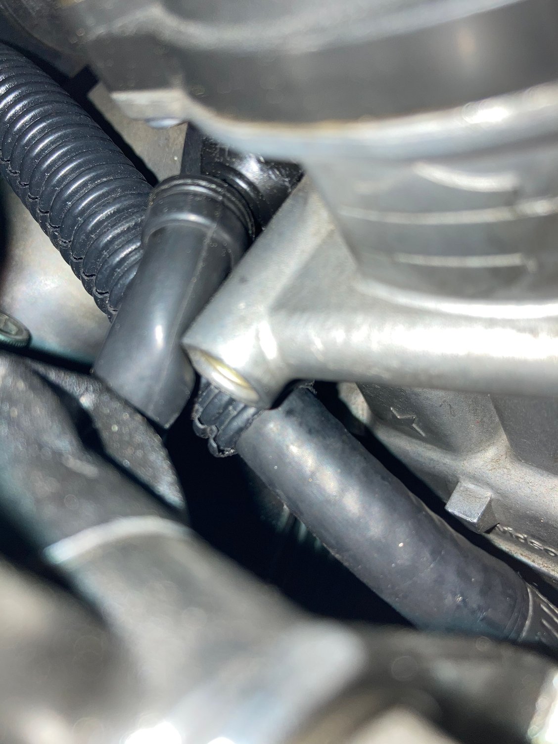

Got a better look in the daylight today. Looks like the cable got snagged between 2 fins and is off the nut and bent down. I’ll pull it back apart tomorrow and reseat it. Hopefully that’ll be the only issue but I’m pretty confident that’s it. Thanks for all the responses.
