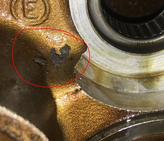

Aloha,
am I right to see some black spots in the housing from a broken breather valve gear?
Old Apr 26, 2021 | 03:45 AM
EVOrider's Avatar
EVOrider
Joined: Feb 2007
Posts: 2,558
Likes: 280
From: Russellville, Arkansas
The black spots were actually grey when I touched it....assuming it was tiny metal ground up shavings. Not the best lighting for pictures.
I don’t understand how the plastic breather gear didn’t get destroyed in the process.
And for splitting cases.....we’re 50/50 on doing that. He’s saying he’ll just changed oil/filter much more frequently and hope for the best. The bike wasn’t having any oil pressure issues.

Did you pull the breather gear out of the bore? I have seen pieces go through and screw up the bore...

Those pieces never made it past the lifters or pushrod covers, they blew outward.

I kind of agree with Dan, wouldn’t you see damage in the cam chest or at least the plastic breather. I would expect to see some remnants at the bottom.
Removed the breather gear and the bore looks great. No damage whatsoever in what I’m seeing.
