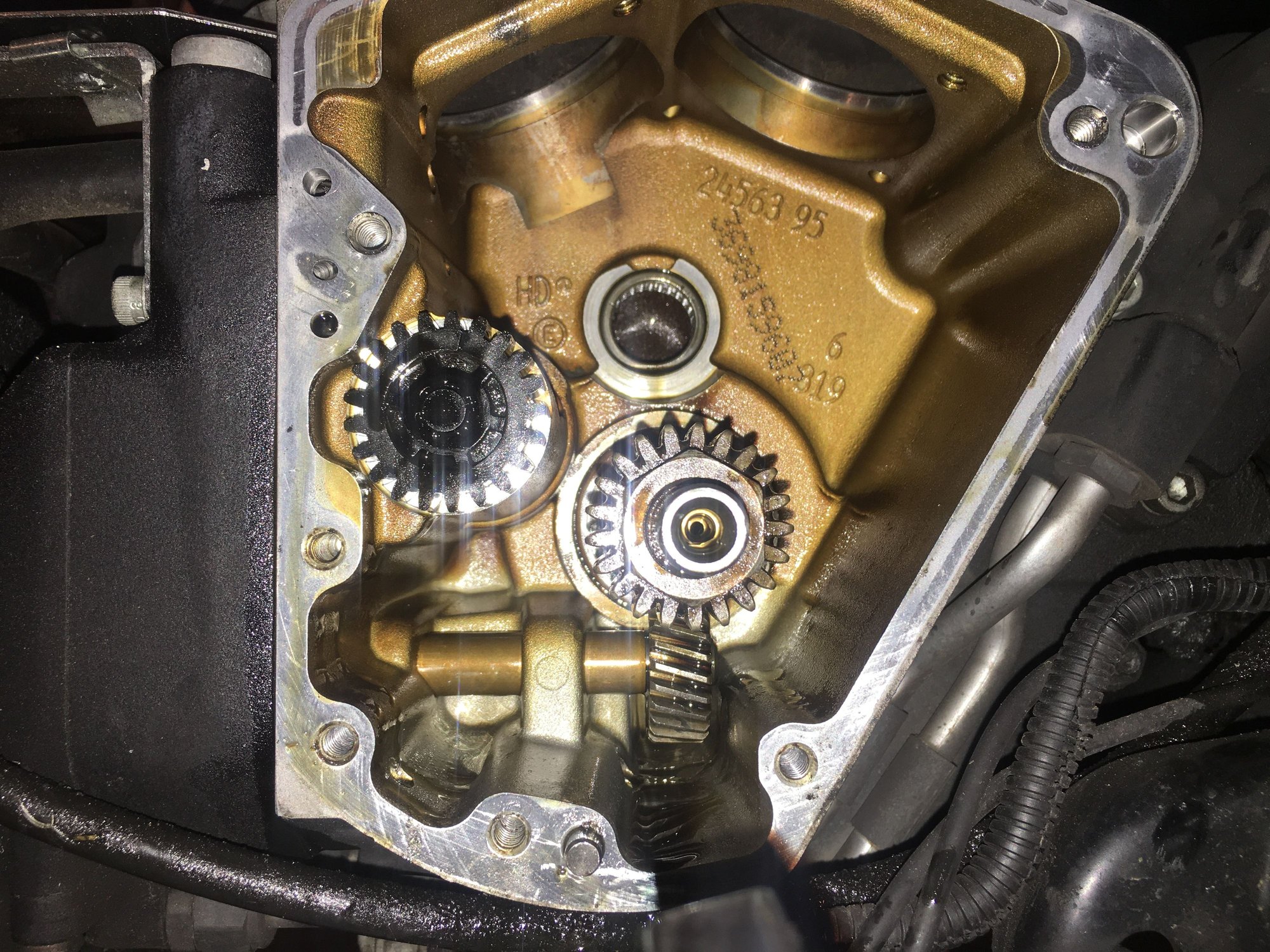

Was running fine with a slight tick.....but that was all.
Thing is....he really brought the bike in for a cam upgrade. Now all this....
Certainly doesn’t look good....will know more in a few more days after I pull the nose cone.

This one will be fun to watch unfold. At least for us. Hopefully your friend doesn't have a major problem.
I'm really curious to find out what's up here. I'm guessing you'll find that missing chunk lying in the bottom of the cam chest.
But it is really hard to think of what could have caused that break that didn't also cause (or maybe result from) something catastrophic.

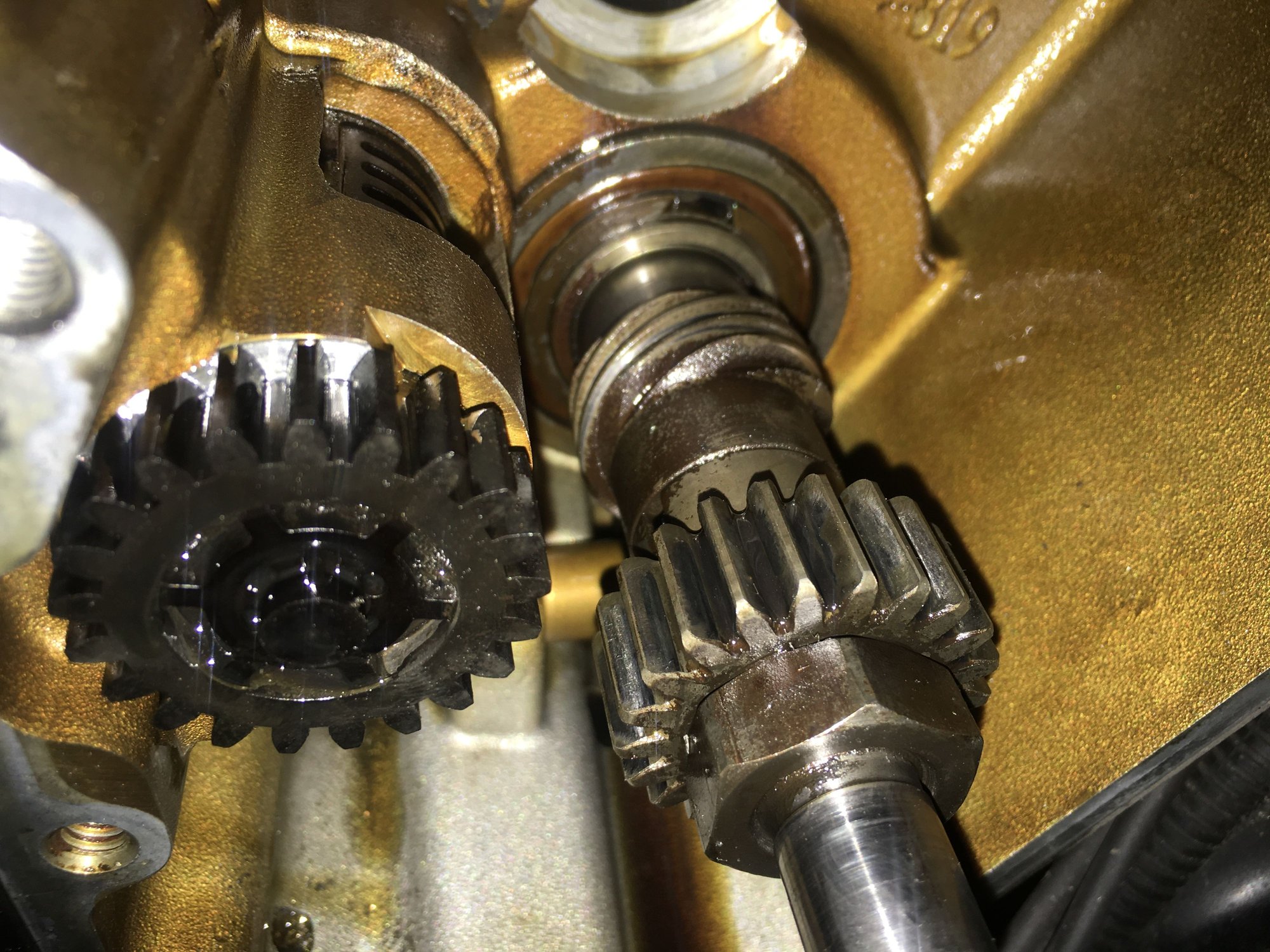

I meant to add this picture of the lifter with the earlier one. The one that’s screwed up came out of broken piece of the lifter block. It’s seen better days.

Got back on it this afternoon.....
No big chunks and no visible damage to cam or any gears. There was just a few tiny grey shavings mixed with the oil.
Went ahead and installed the new Torrington.
My question.....What next? No big chunks...could it gotten ground up enough and caught in filter?
Check the oil pump?

I'd sure want to ck the pump and lifter screen if I'm saying that right.

Lifter screen was super clean.....
