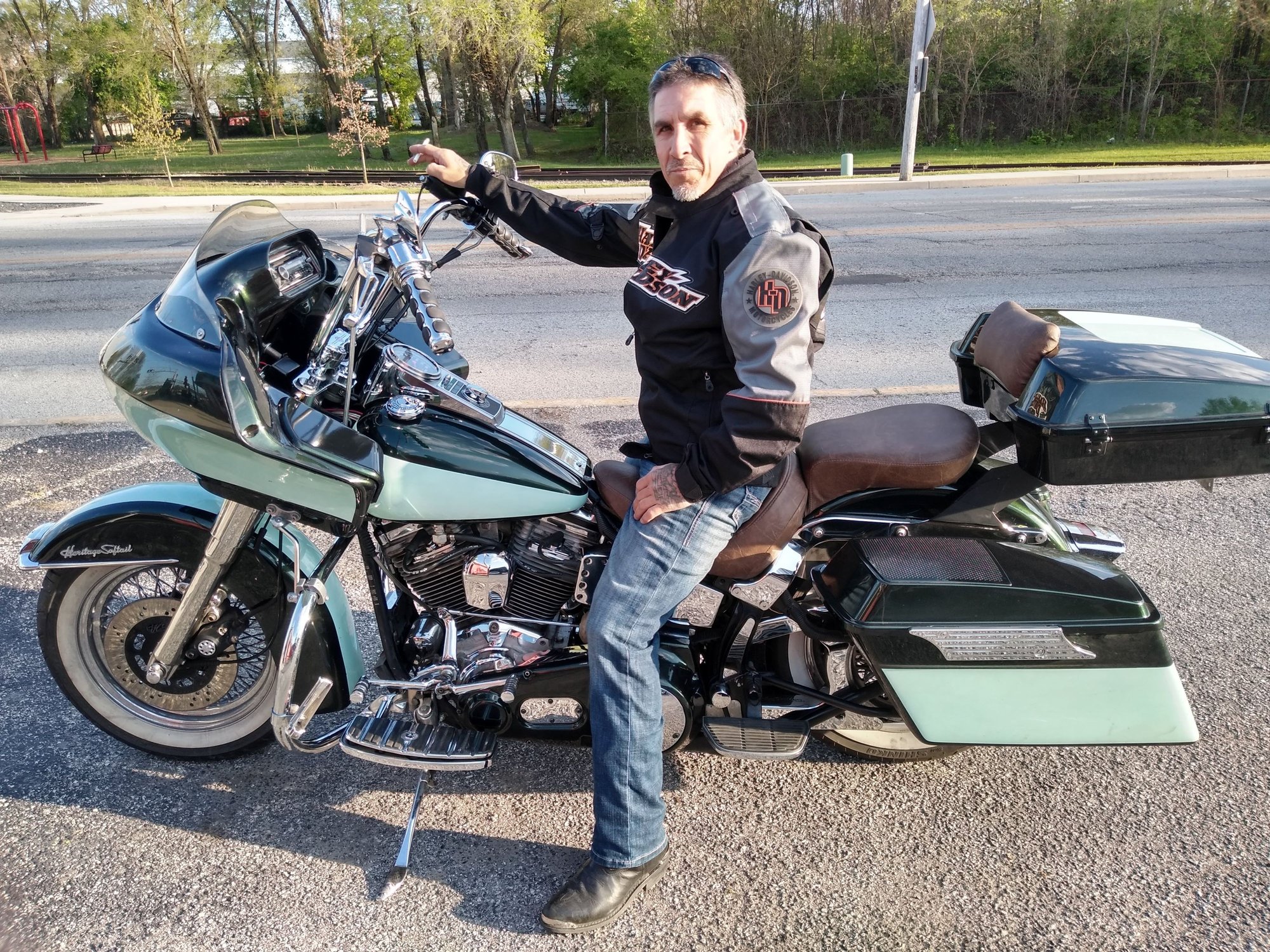

I have a 1988 Harley Davidson Heritage Softail that is anything but stock. Delkron cases Wiseco Pistons adjustable pushrods Andrews EV27 cam Dynatek 2000 ignition CV carb with Yost performance kit ( not sure jet sizes ) bought carb already done, switched from S&S, also running open k&n filter, has Harley 2into1 header pipe with cat cutout and baloney cut slip on with baffle. It has roughly 8500 miles on total rebuild, .030 over stock with mild head work, guessing port and polish. I do alot of club riding and rely on dependability but would like a bit more power. I also run an All ***** starter and need to get new ignition system timing better as it is sometimes sluggish to turn starter. Just looking for performance and tuning advice as I'm always doing something to this machine.

I don’t have any advice….but that is one good looking bike with lots of time spent on it. Good job on a Softail modified into a Road Glide.
It’s cool and I don’t see that everyday!
Thank you Evorider, I call it my Roadtail, it also has 400 watt, 10 speaker stereo system. 2 6x9 in each bag, 2 mid range and 4 tweeters in fairing
