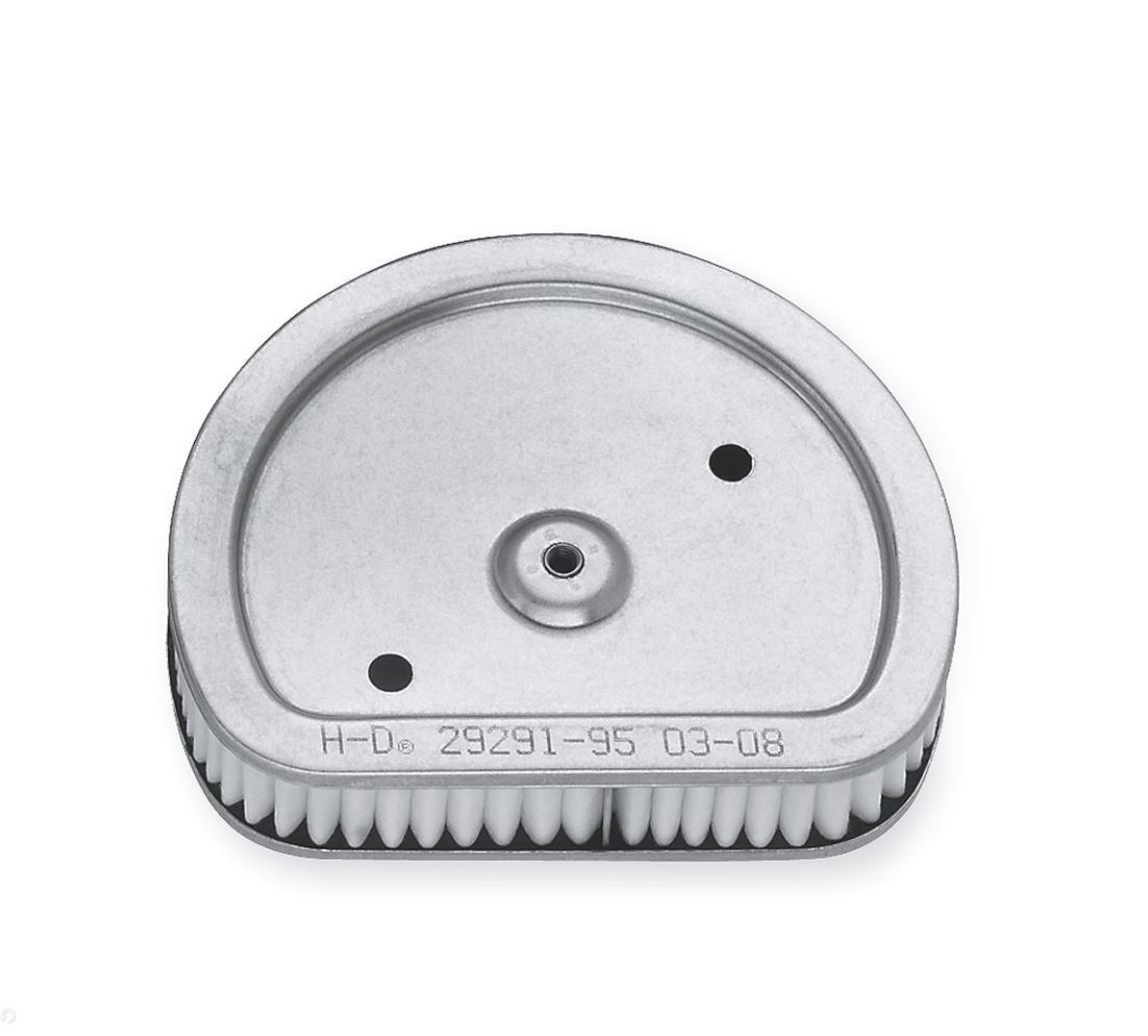

Sorry for all the questions on this bike, but I have no way of contacting the previous owner, so I don't know what has, or hasn't been done on this bike. This is the air cleaner that is on the bike. I know it is HD, but is it from OEM/Stock or Stage 1? Bike is a 1998 Ultra.

That’s the stock air cleaner. Are the rivets still on the points cover? That’s a good sign something has been done….but not all the time.

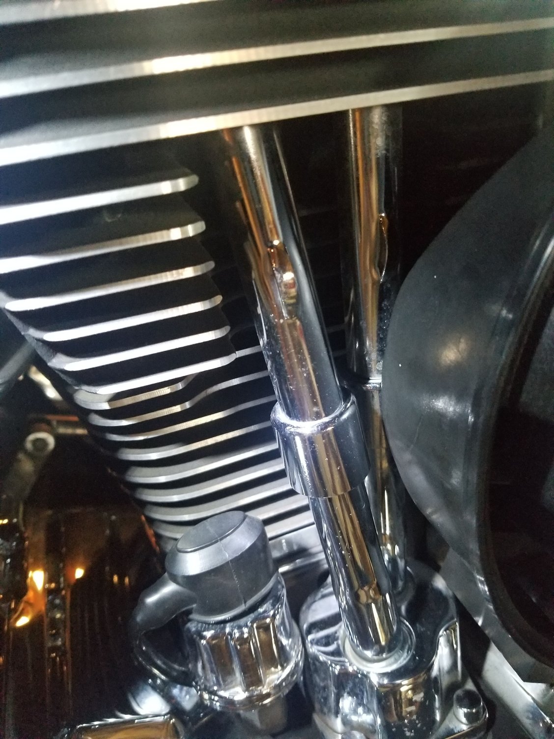

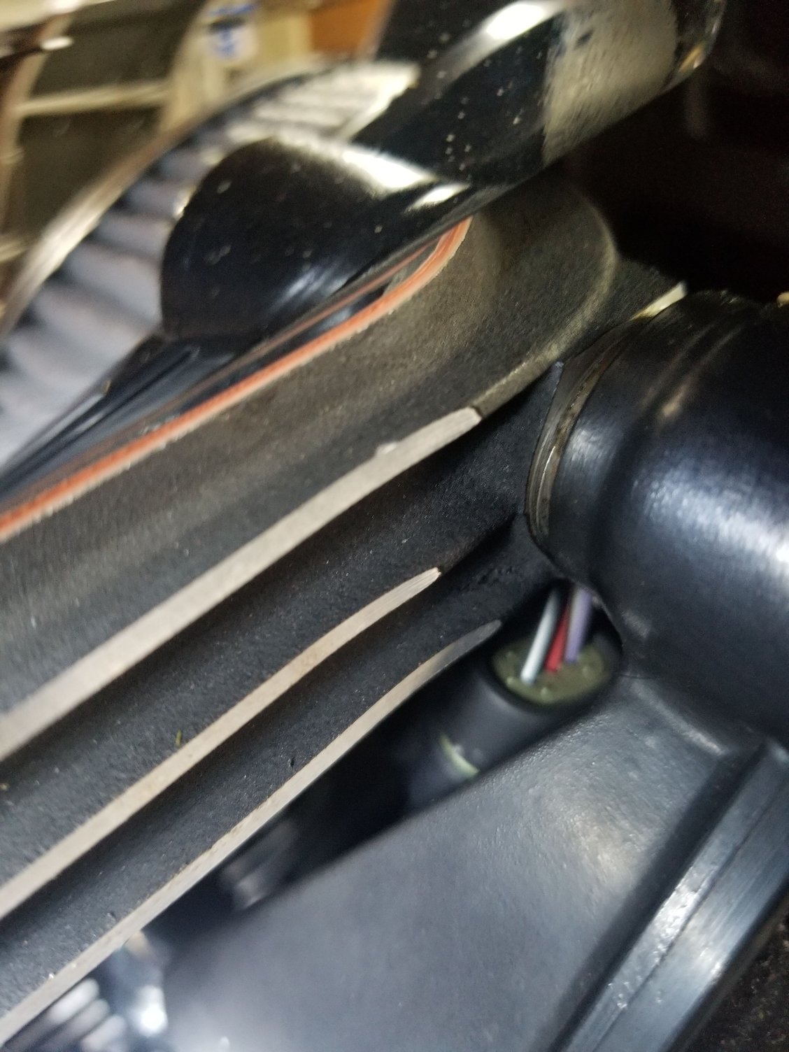

Thank you. I probably need to take it to the dealer. I did take a couple of pics.

My guess not to many mods done if it has a factory stock filter. Does it also
have stock type exhaust pipes with the cross over?

It’s got chrome lifter blocks…..something has been done. Factory ones are black.

The red line between the lower rocker box and the head looks like a James gasket. If so, the Rocker boxes have been off at some point.

I wonder if those are covers after looking at the "bolts" as they look like covers.

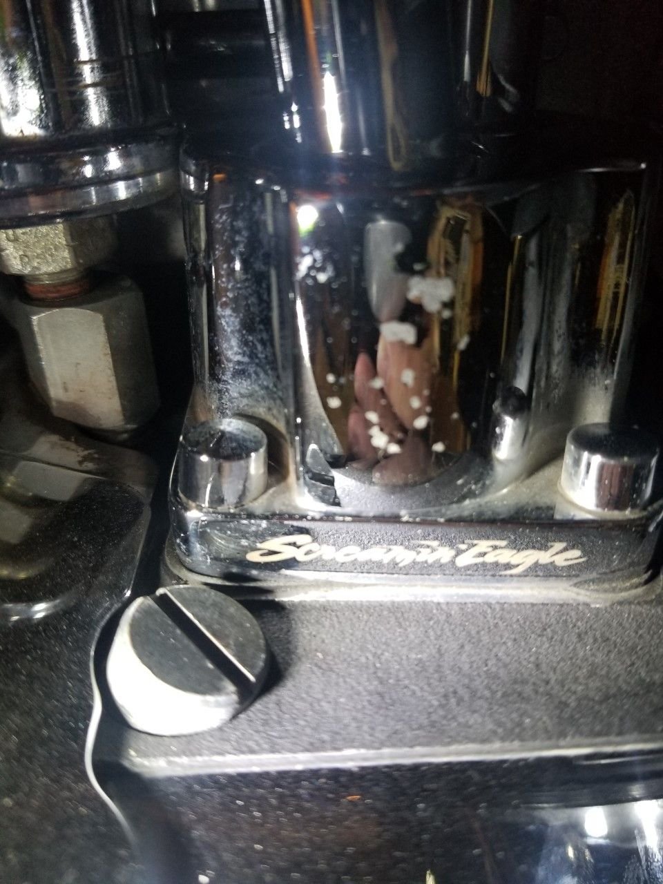

Here is a better pic of the lifter blocks. They say "Screamin Eagle" on them. They are not covers, but solid.

^This^
Those look like those stamped steel covers that HD used to sell.
