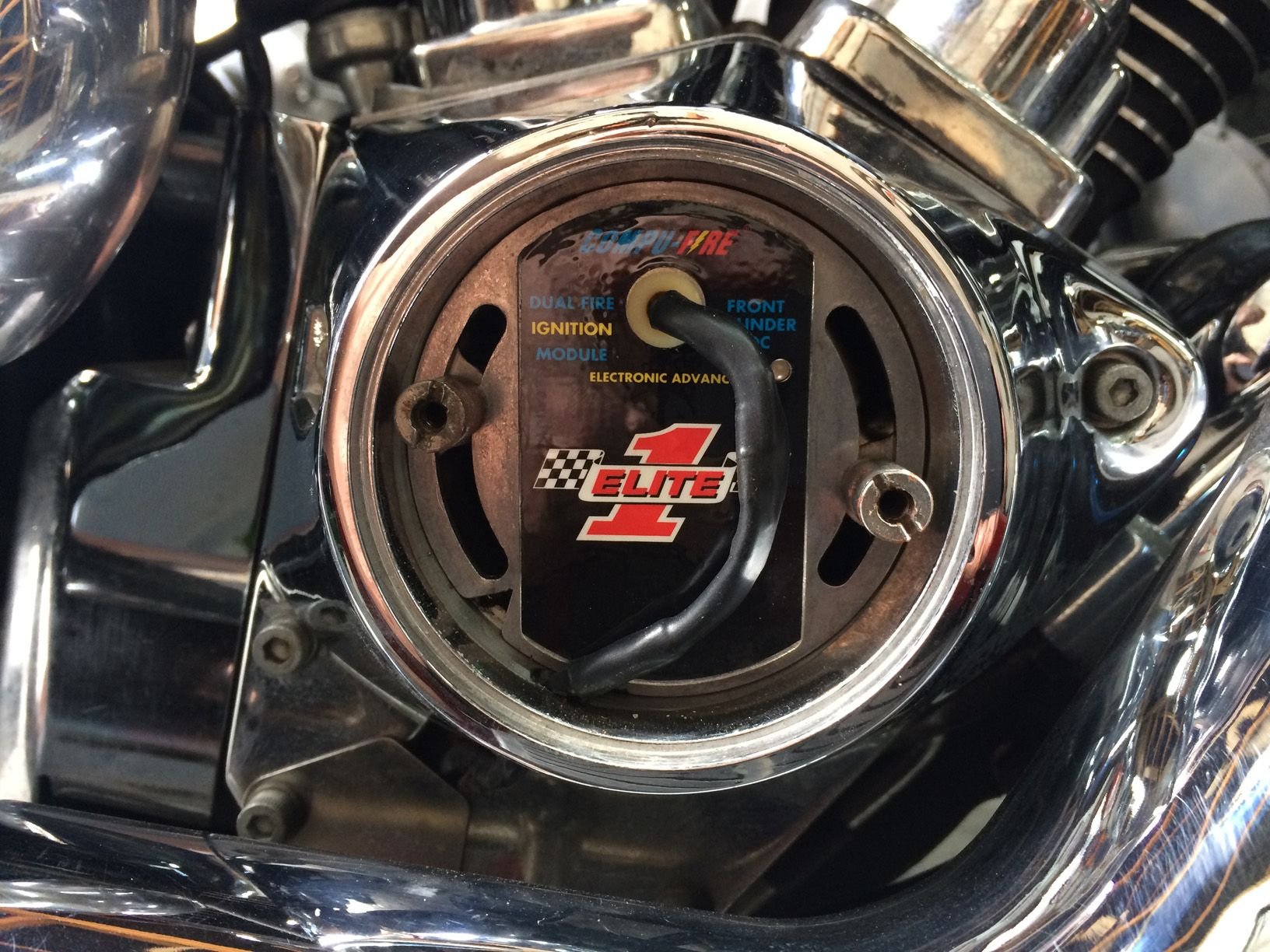

It's the 8 pin deutch connector for the factory ignition module.. I'm sure some one installed an after market ignition.. Pull the cam position sensor cover and post up a pic.. How many wires on the primary side of the coil, 2 or 3?
Well spotted.

Pretty sure the Compu-fire ignitions still used a centrifugal advance of the end of the cam.. Might want to remove the ignition and have a look to make sure the posts for the weights are not worn.. And that they move freely and the springs look ok...
