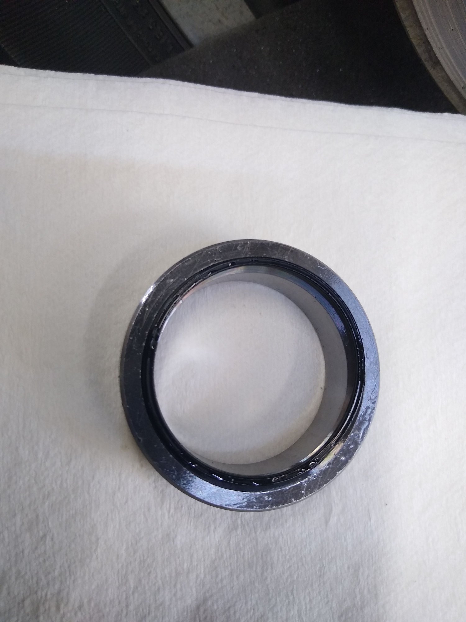

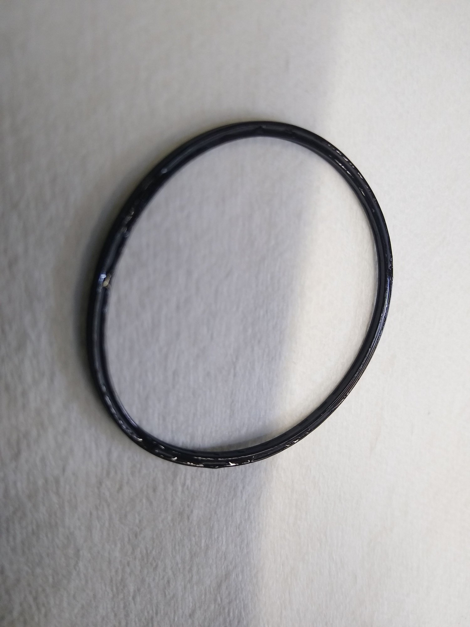

I have another issue. There's a new oring oil seal that came with the new sprocket. I also have the used one. But for the life of me I cannot locate it in any drawing assy or instructions. Not sure where it goes.

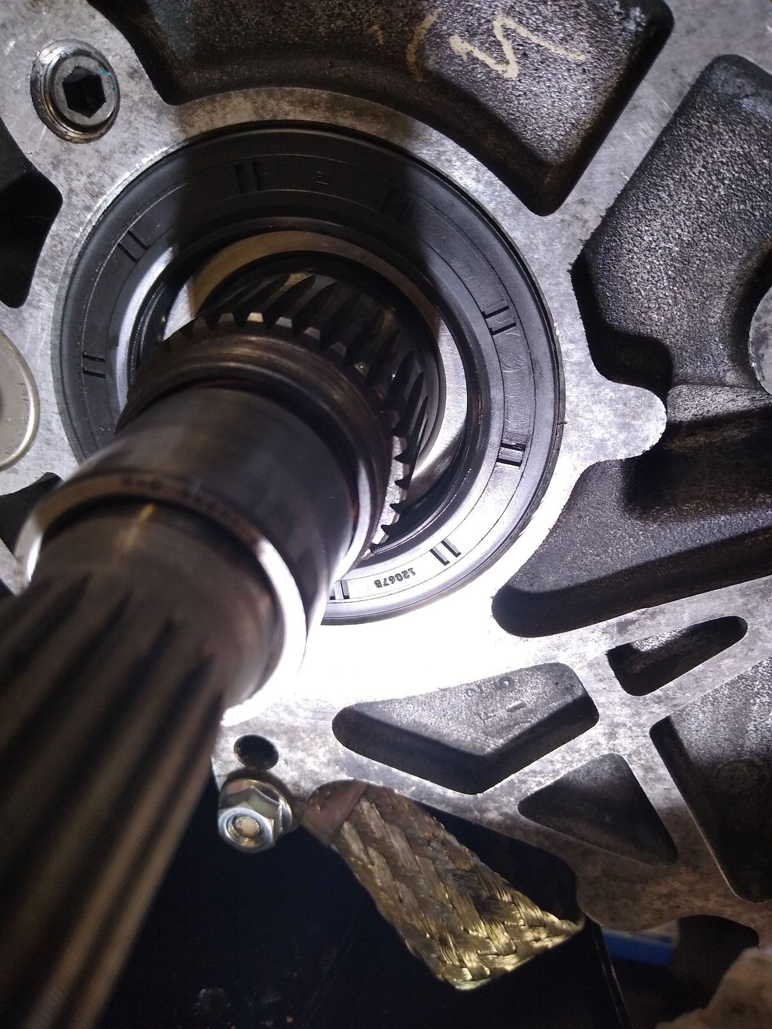

This is the only config that makes sense to me is in-between main bearing and spacer. See following pics.

Yep. Slide it over the splines then put the spacer on. Dry only, no sealant. That sure is shiny ground strap, where'd you get it?
