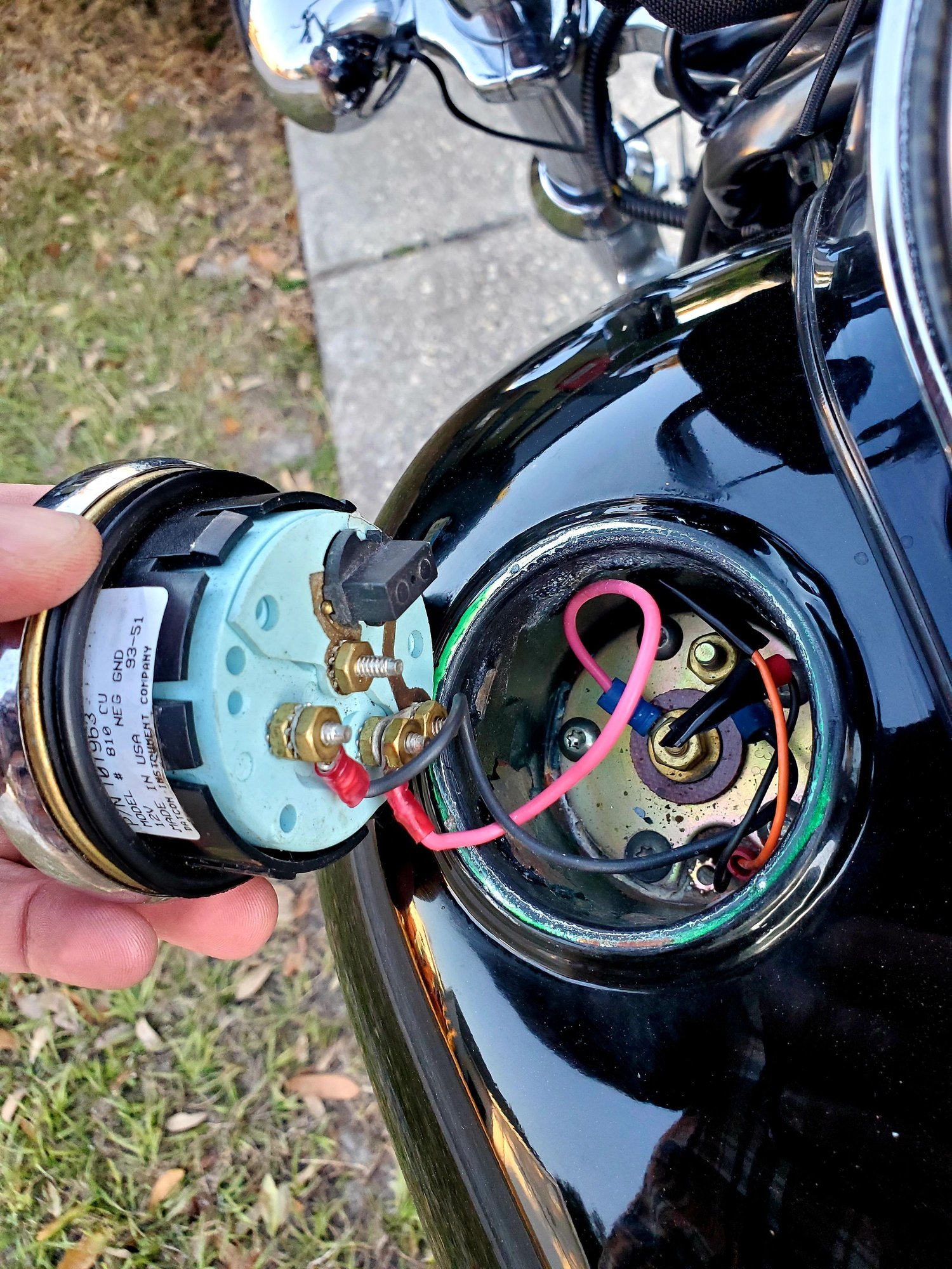

I took apart the carb and gave her a good cleaning. I went for a little ride after and she is running much better and looks like it fixed the leaking fuel from the overflow line. New plug wires, air filter, and fuel filter installed.
I found the OEM fuel gauge in the box of small parts my Dad gave me. I need to find the wiring diagram to get it wired up right, nothing on the back of the gauge is labeled. She looks much better with some nice OEM fuel cap and gauge. No work tomorrow, I'll get some more work done and go riding. I need those rear blinkers installed.

Wired in my OEM turn signals, glad to have those back. Put in a better looking seat bolt.
I found the wiring diagram for the fuel gauge cap in my manual. I wired it in and it worked! It went up to 3/4 tank when I turned on the ignition. The light didn't work but that could be the bulb. However, by the time I went out for a ride after finishing up all the work, the gauge stopped working. Weird. To add to the bullshit I found a pool of gas under the bike this morning. One step forward, two back.
