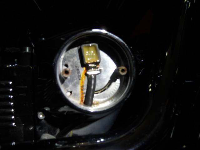

Before you leave you'd best check under your timing cover for signs of this -
When these things start to melt ignition failure will be coming soon and you don't want to get left stranded.
