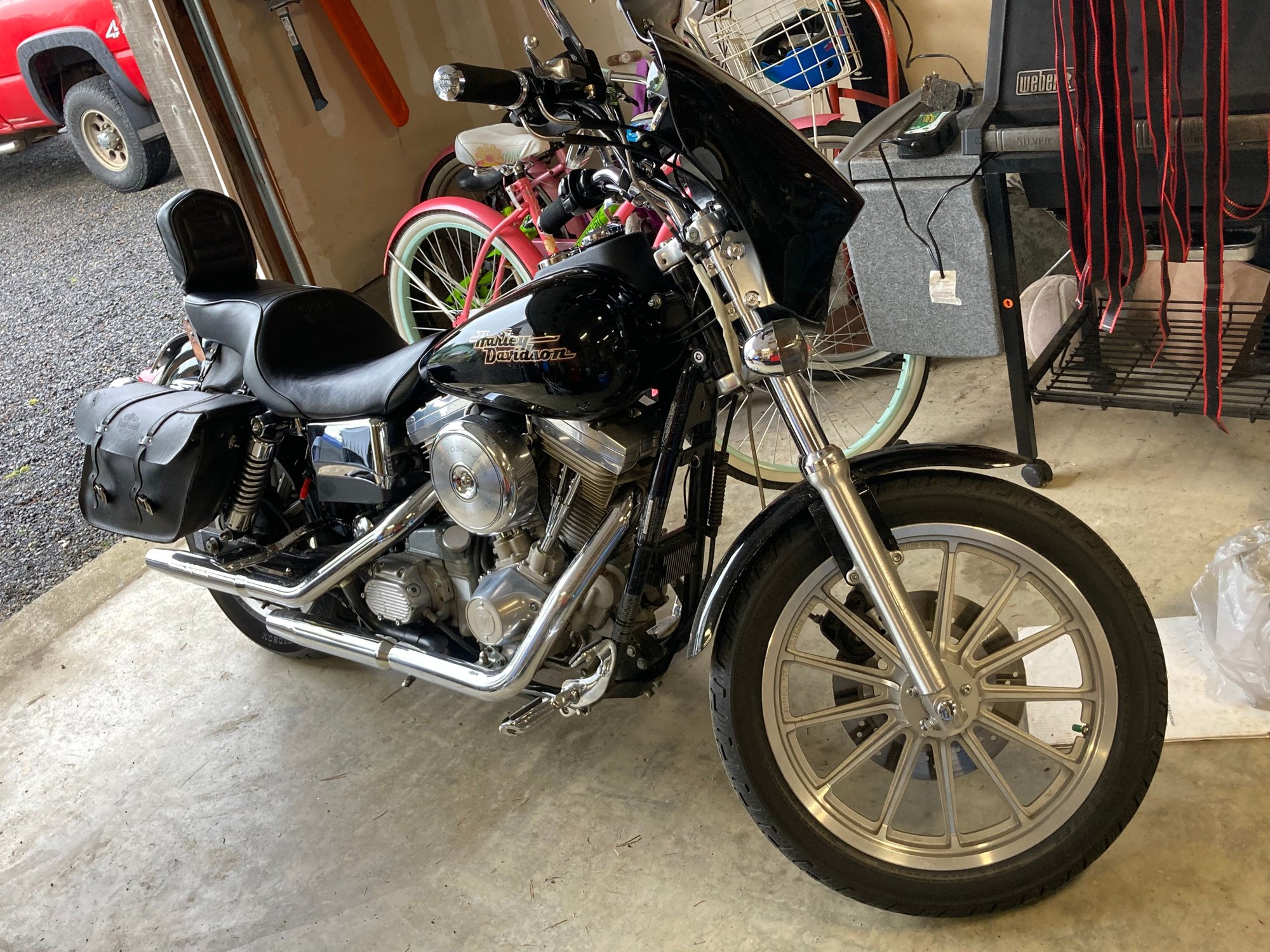

I’m planning a 2-week multi-state go where the wind blows kind of trip in May. I’ll be riding my new-to-me ‘96 Superglide.
I have a few hundred miles on her now and so far I think the comfort will be fine (she conveniently came with a batwing Memphis Shades fairing they helps a lot). She’s also running like a top. No issues I’ve identified. Maybe once every 2-3 rides rolling on the throttle it just coughs for a second but that’s the only odd thing I’ve noted. Otherwise we’ll kept and a solid 9/10 condition for the age.
Obviously I’ll be running good tires, brakes and a fresh 3-hole oil change. What other things should I be checking?
so far I’m thinking:
-full check of charging system
-considering starter additional relay I’ve read about
-maybe confirm if cam bearings have been changed (would need to research that more)

Except for a couple of bolt on items I see the bike looks stock.
Change the brake fluid.
As well as previously mentioned items.
