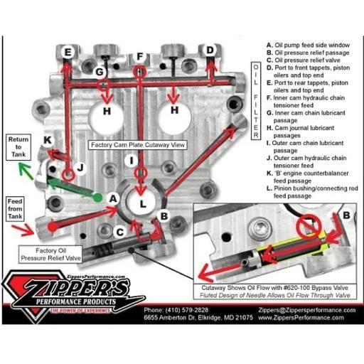

ITwinkies and M8's because of the pressed in crankpin and 2 pc flywheels rely on a splash bath to oil the rods.
Twinkies and M8's always used oil passages to feed the rod bearings, through the cam plate and pinion shaft to the rod pin.
