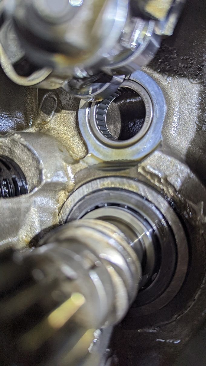

Adjust the pushrods down.. Get it apart and pull the cam.. Post up pics of the inboard end of the cam, the lifters and cam bearing.. We'll see what kind of lifters are in there and we'll go from there.. as for the push rods I would think the rear intake possibly loosened up that's awful short.. Once everything is apart we'll measure the pushrods when completely collapsed to make sure the 2 longer ones are installed for the exhaust valves and the shorter ones for the intakes..

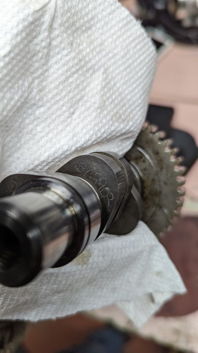

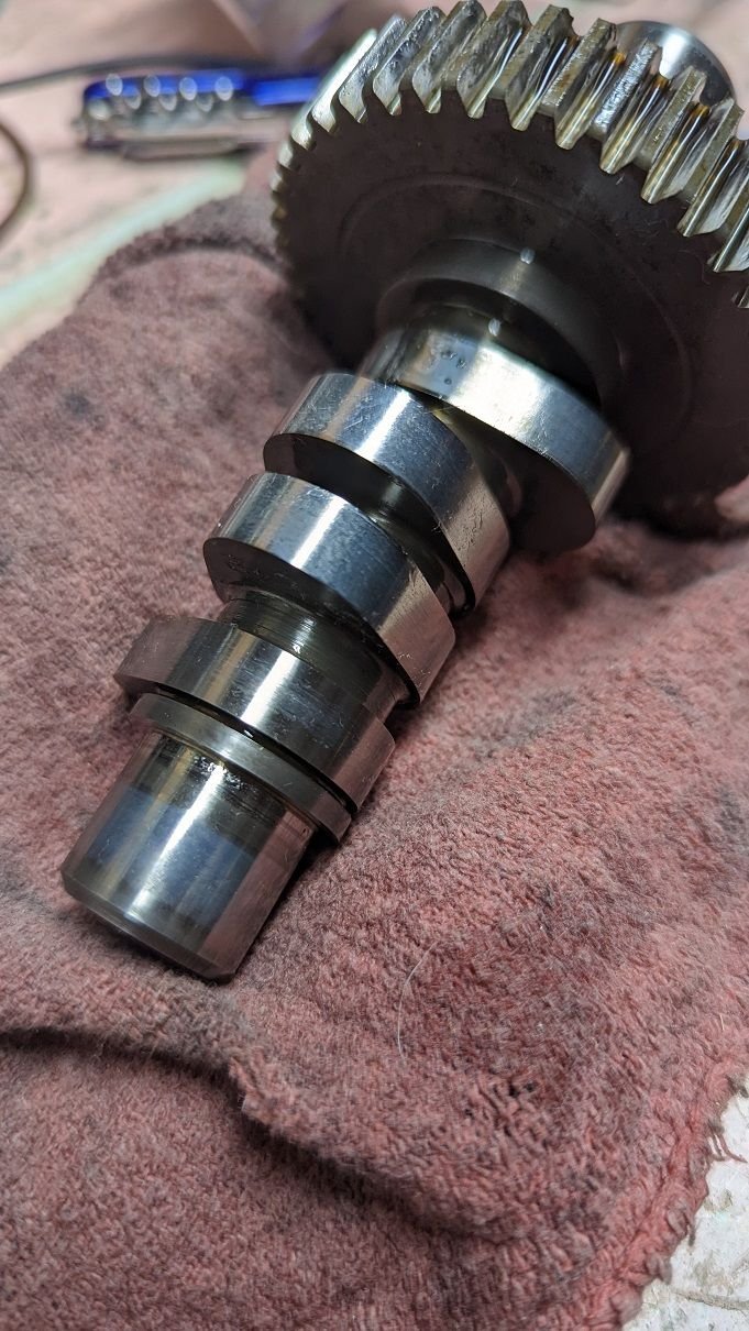

Looks like the cam reads FB310.2 and the next lobe in reads 39-99CR, and there's a Torrington bearing already in there.

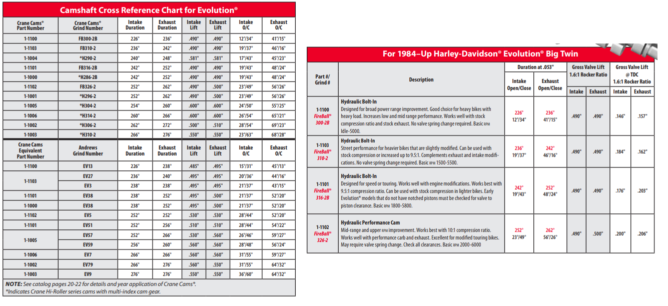

3 minutes of google fu led to a Crane FireBall cam
