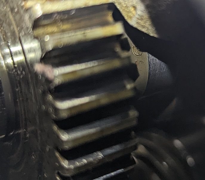

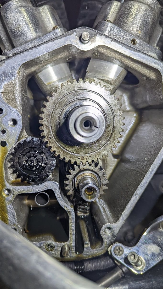

Default Cam Identification
Finally tore into my cam chest to see what cam my FXR has in it. The previous owner said he changed it out long ago and can't remember what cam he put in it, and since the bike has S&S Super Stock heads and a Screamin Eagle Mikuni HSR42, I would imagine it's not stock. I'm still in the process of looking for any identifying marks.

I was able to see a 66 or 99 on the lobe, only markings I've been able to find so far.

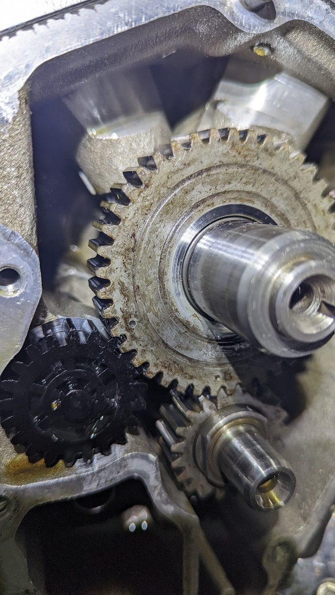

Whelp, after doing some reading, it sound that just popping off the cover is a big no-no without releasing pressure off the cam from the pushrods. Popped the cover back on and now looks like I'll be replacing the cam bearing too.

Cam identification can be on the other end of the cam ... the end that goes into the bearing

Yup, your gonna have to relieve the pressure off of the lifters by taking the top end apart.. Or you can cut the pushrods and replace with quickies.. Then pull the cover and cam.. As said on the inside end of the cam will be the identifying marks.. post up a pic of both the cam bearing and end of cam shaft.. Just because you took it apart the way you did, does not justify replacing the inner cam bearing.. Let's see what you have first.. pics....
