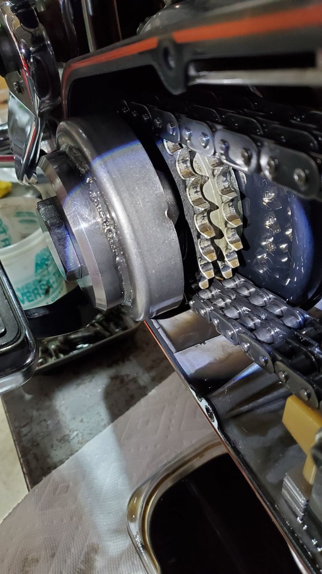

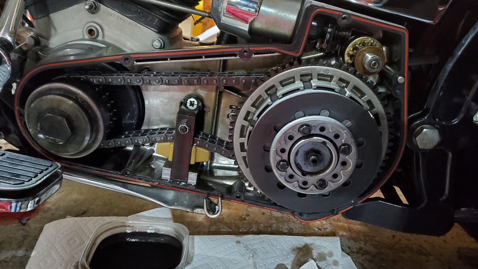

No clunks or noise from the primary. Engine mount bolts were tight. Pulled the primary cover. Fluid was a little low. Small amount of shavings on the plug but the fluid looked ok. Compensating sprocket nut is finger tight. I didn't try to torque it. Not 100% clear on how to lock the sprocket. Nothing feels loose. The chain tensioner is spring loaded. I assume this is an auto tensioner?

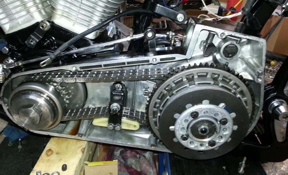

compared to a original Softail set-up of the same years as yours:
It could be the photos or my old eyes but your primary chain looks as if it runs with a different and sharper angle on the lower part of the stretch.
Do not pay to much attention though, cause I can not figure out how that could even be possible.

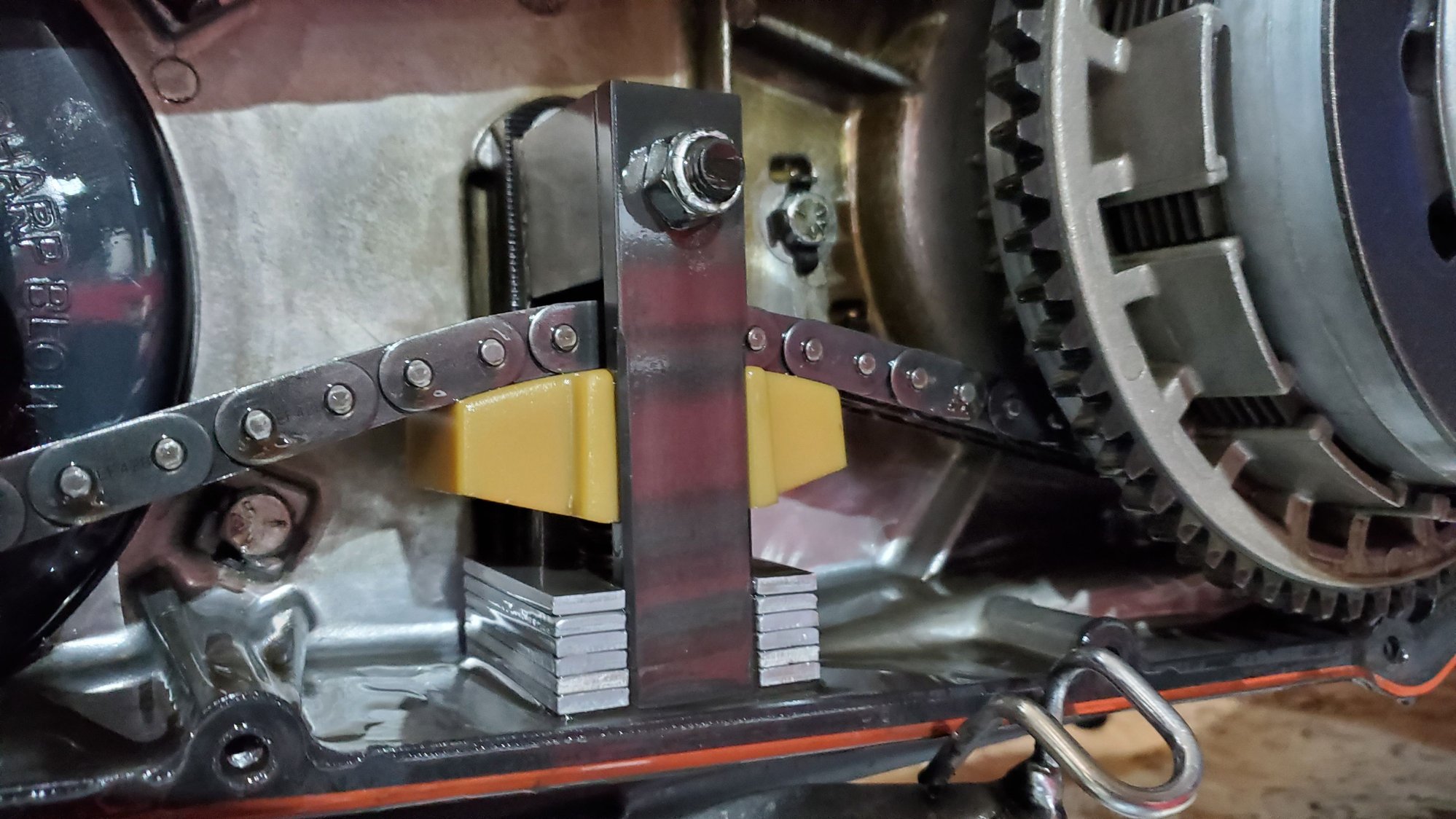

You have a Hayden auto adjuster imo makes for smoother shifting and not worrying about adjusting.Looks like ur primary chain may be a little stretched judging by the stack of spacers.I know mine only uses 2 when set up.Maybe time for a new chain?

That's likely your problem. Most use a steel bar between the chain sprockets to lock them for torquing and the nut should have Loctite 262. Correct torque for that year is 100 ft/lb
I agree with 86glider. With that amount of shims, your primary chain is worn out. You can see the chain is almost hitting the top cross bar. They'll stretch forever, but when badly worn, they also have lateral flex and all that adds up to bad vibes. The compensating sprocket nut being loose is the biggest issue.
Have the shop replace the primary chain and they'll get everything torqued during the process. Be sure to tell them 1/2" - 5/8" between top shim and bottom of shoe. Not every shop is familiar with the Hayden adjuster.
