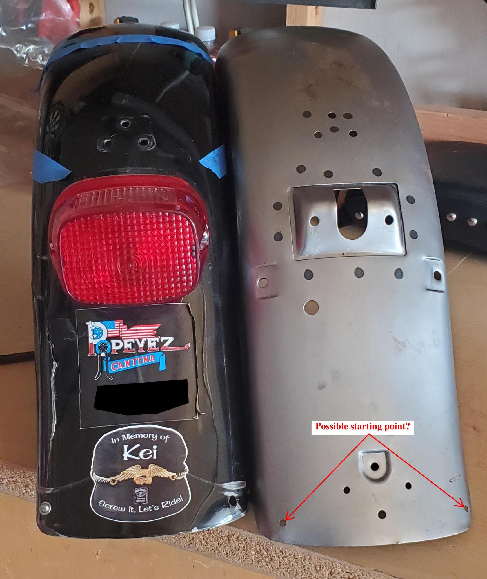

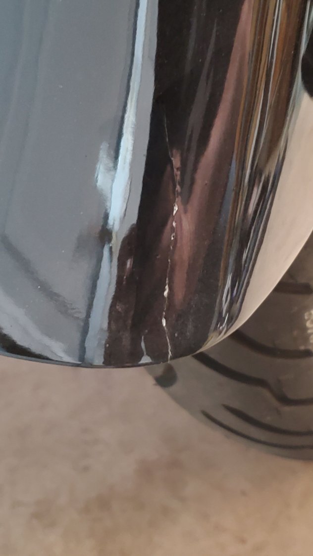

This might need to go in the paint section but since I'm already here.. The rear fender had a long tear when I got it. Previous owner claimed vibration was the cause. I assumed it was more likely a late night curb hopping but it appears he could be correct. I got a new fender and paint. New fender probably has less than 150 miles on it and is starting to tear again. This time on the other side. I had the body shop fill holes and recesses to match the existing fender. This was done with some sort of filler. Would welding the holes be a better route?

Yes the bike is a solid mount engine.. Could be when the motor was stroked it was never balanced (different heavier pistons).. But to answer your question yes the vibration if severe enough will do that to the rear fender.. Hell, one of the wheels could've shifted.. What crank is in it? if you open the timing inspection plug on the left side case you might be able to see some type of serial number of the wheels.. Post up a pic if You can... I think you should take it to a reputable Indy and have them take a look at it...

They all vibrate, but if yours is vibrating to the point that its breaking the tins, that's a whole other ballgame.
