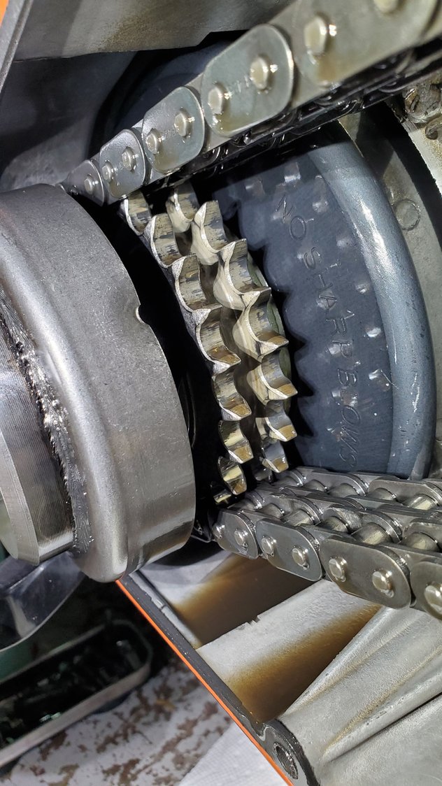

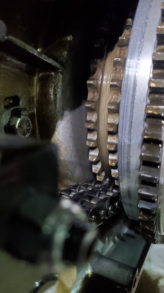

While you're at the chain, count how many teeth are on both sprocket's (front and rear) and if you wouldn't mind posting up a good picture of both the compensator and clutch basket sprocket's...

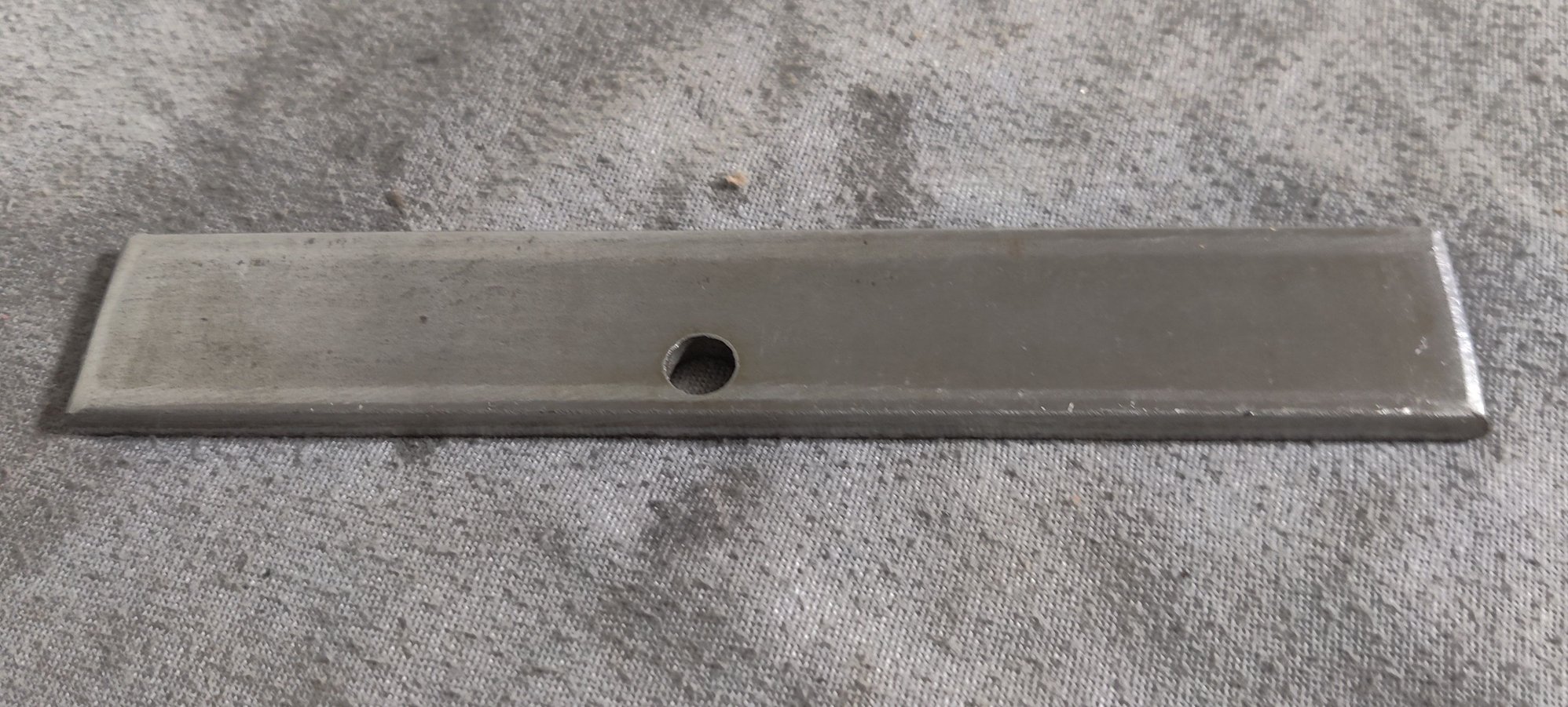

IMO, best device to lock out the crankshaft and transmission shaft to remove and install the nuts is a flat bar locking tool. I believe it's 7 3/8" Long by 1/4" thick by 1" inch wide (measure your to confirm).. Don't forget to round the ends to fit the sprockets better.. You can buy them or make them like most of us..
Compensator 24
Clutch 37

Stock gearing, that's good..The comp sprocket is showing some wear, the clutch sprocket looks great.. If your going to do the chain then replace the comp sprocket as well.. ..

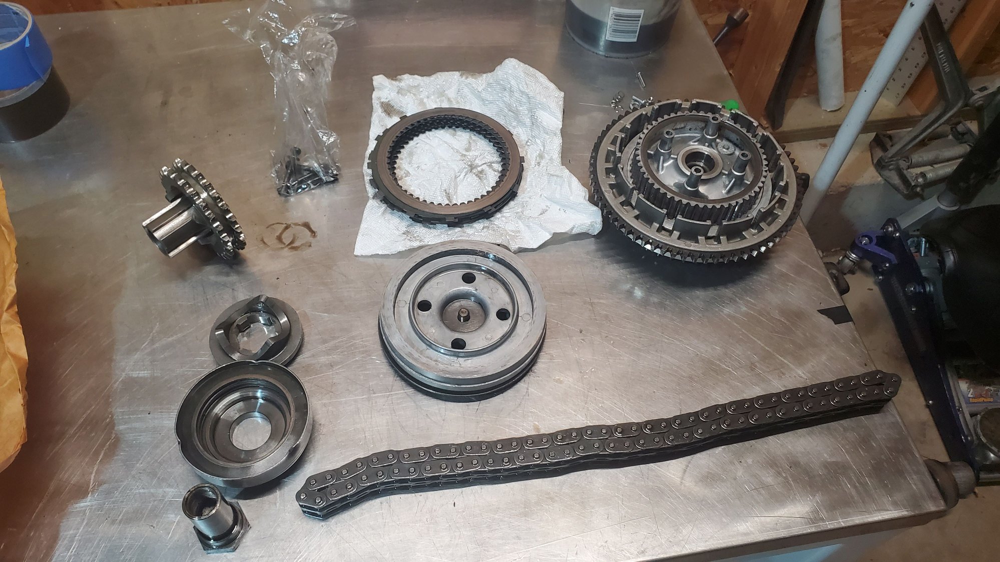

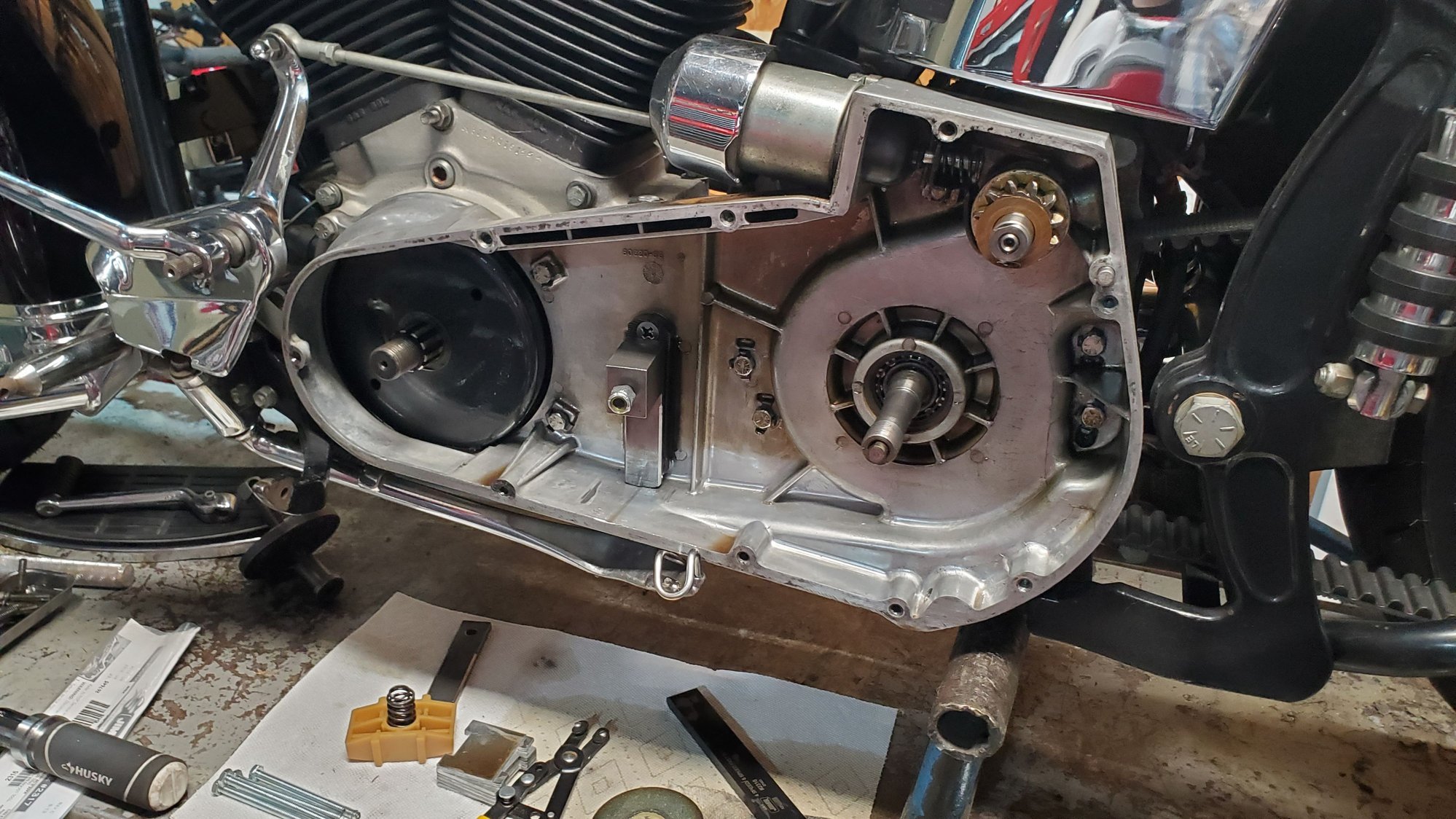

Unfortunately all I have to offer are baby steps. Got a locking bar. Removed compensating sprocket, chain, and clutch basket. For some reason I thought I wouldn't need to remove the clutch but here we are once again beyond my comfort zone. Still waiting on the chain to ship. Should have been here last week but it's looking like the first week of June best case scenario. JB welded the cracks on the old fender and mounted it up. Got an overhead shop light so I can see what I'm doing on the left side of the bike. Now I wait...

Chain finally arrived late last week and I was able to get everything in last night. Busy week but I hope to be able to ride and report by this weekend.
New chain is shorter but not as much as I had expected.

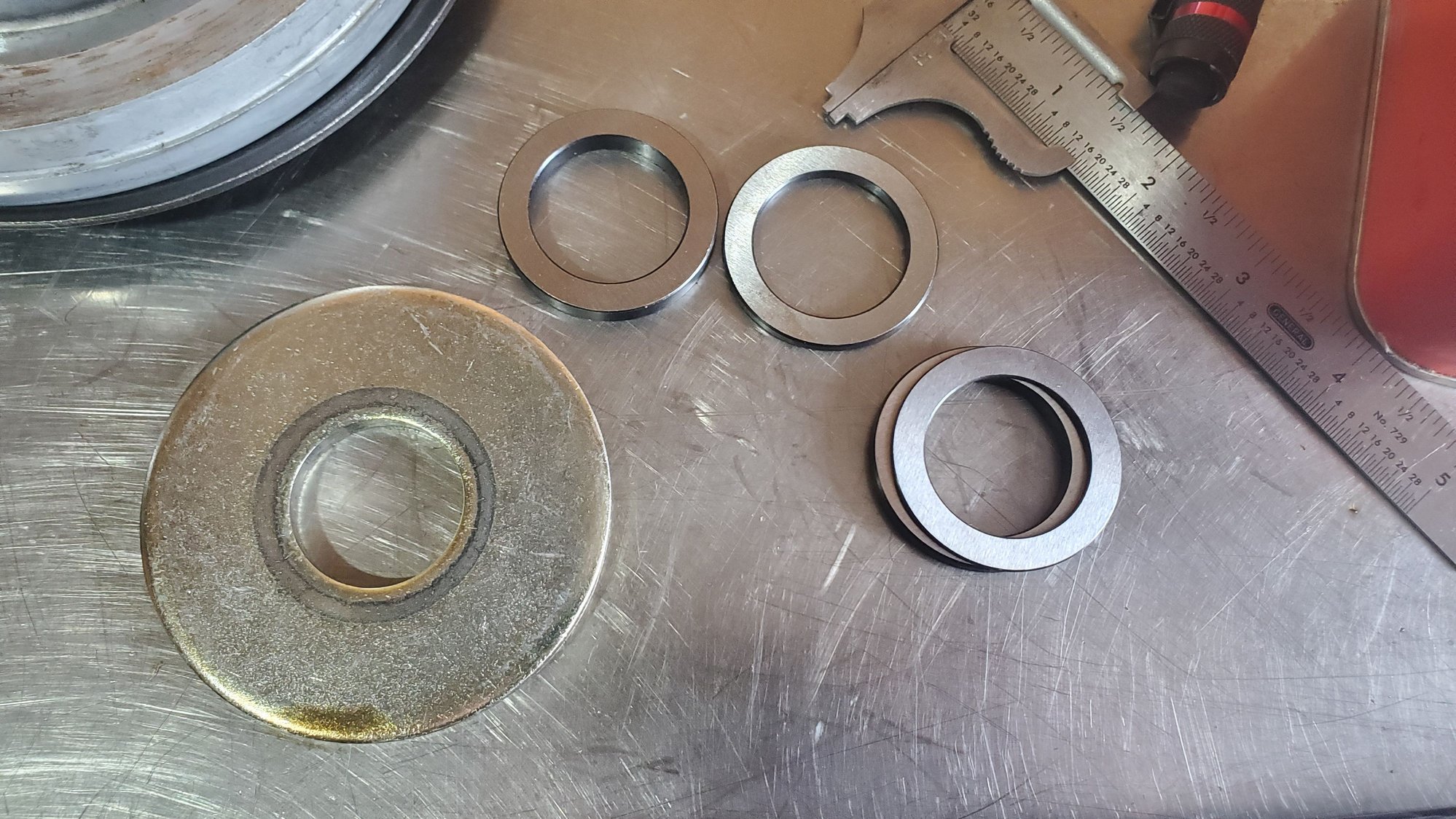

Old compensator spacer on the left. New spacers on the right. Chain was properly aligned prior to removal but I wonder if this big *** spacer could have been a factor in the vibration?

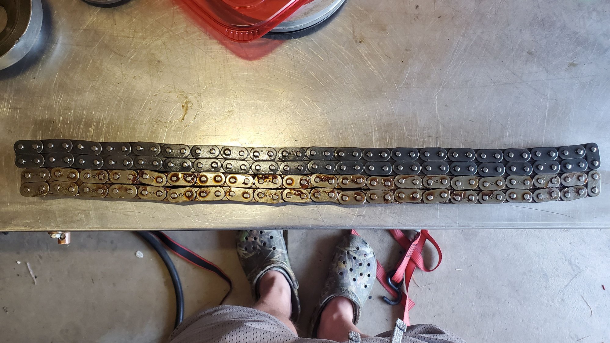

Looks much better! Old chain had 6 spacers new one has 2. I've got to test ride sooner than later. The anticipation is killing me.
