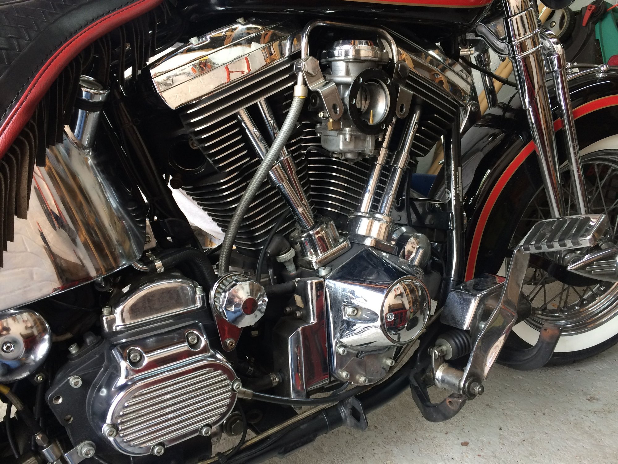

The photo below shows where I've got to.
It says in the manual to take the rocker boxes off before going into the timing nose cone......is that right, or can I go straight for the pump?
I also took the screen out and it was clean and it was full of oil.

Just go for the pump, don't worry with the cam cover removal for now. You may end up in there, but the oil pump can be R&R'ed by itself.
Drain the tank first. Get the breather filter out of the way, looks like an add on cover for the pump so whatever that takes. The oil pump cover comes off after removing the hoses and 4 bolts. If there is a problem with the feed side of the pump, you'll see it. If not, plan on the cam cover coming off.
To finish removing the pump if you choose:
There is a tiny lock ring on the shaft of the drive gear, get that off. At that point and if possible, rotate the engine so the slot for the woodruff key is up. Do not push or allow the shaft to move forward into the engine more than 1/8"
Pull the 2 feed gears and key. Remove 2 top bolts from the pump housing and slide it off. Return gears will slide off. That's all there is to it.

You may be able to tell something (no guarantee) after pulling the pump cover and idler gear, then see if you can turn the drive gear of the pump. It shouldn't turn. If it does, the issue is definitely on the other end, inside the cam chest. But again, no guarantee because whatever may be wrong inside can foul things enough that turning the shaft is difficult or imposible.
Bottom line, these pumps aren't bullet proof but are very reliable provided debris isn't introduced into the gears causing a sheared key and/or broken gear. Most often that happens on the return side, so they still pump but don't return the oil.
