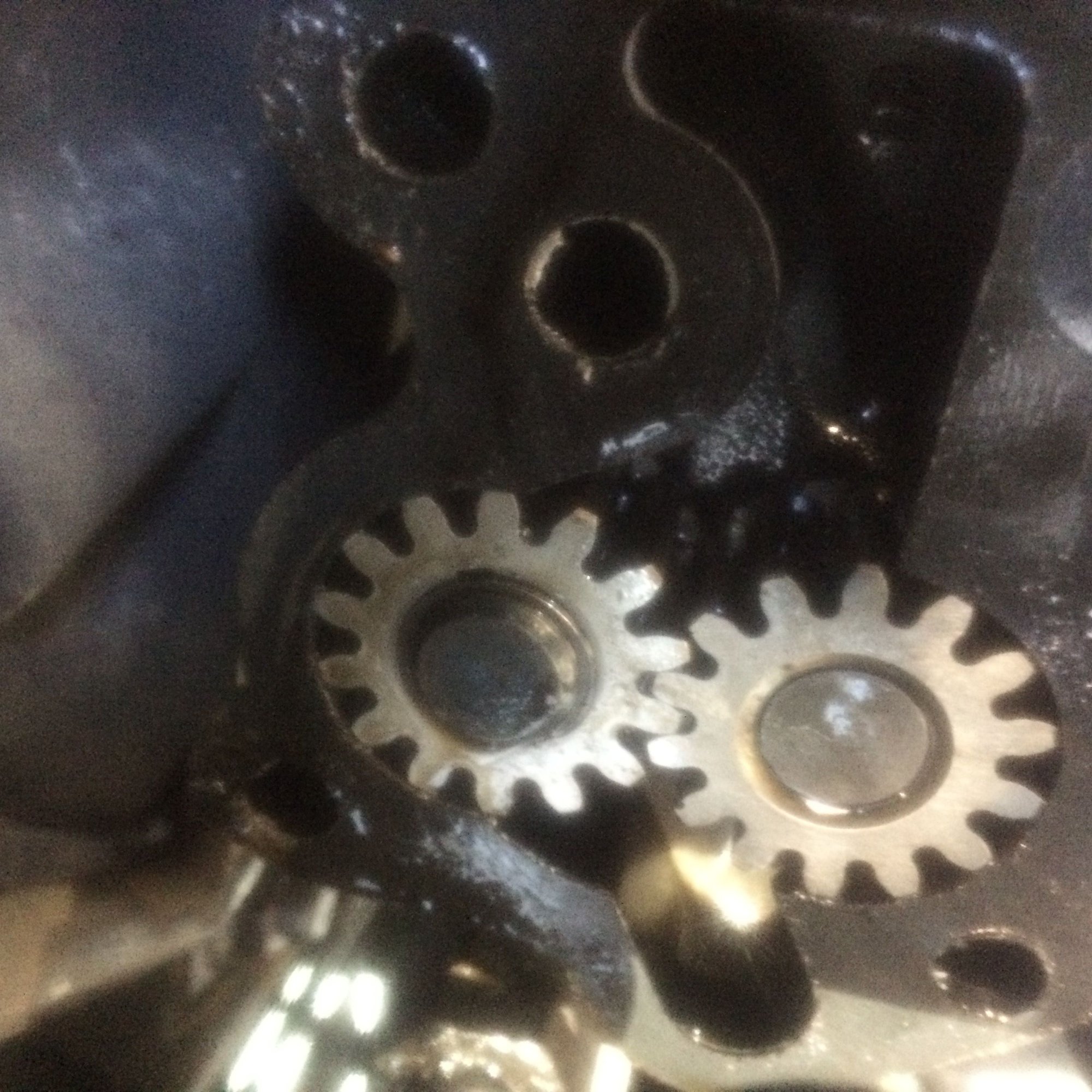

Most often that happens on the return side, so they still pump but don't return the oil.
But my oil tank was full, so surely the problem would be with the feed?
I've taken the cover off......... sorry for the poor quality cover.

Nothing visibly wrong in the photo. Slide the right gear out and try to turn the left (drive) gear. You can pry on it with a some sort of plastic. It will move ever so slightly but should otherwise be solid in either direction. If possible, turn the engine and re-check. Checking a sender requires a pump and fittings. They "open" at 5psi and are grounded with no pressure.
Simple but messy method - put the pump cover back on with the old gasket, attach feed line, put in a small amount (quart or less) of the old oil. Remove the sender and you could put a hose with a 1/8"npt fitting in its place and route that to a container. Remove the plugs, turn the engine over with the starter. If working, it'll push oil out the sender port easily at starter speed. If it does, replace the sender and cover gasket, give it a try.
I sincerely we all have not jumped the gun and caused you unnecessary work.
I took the right gear out and tested the other cog. just a very slight movement in both directions.
