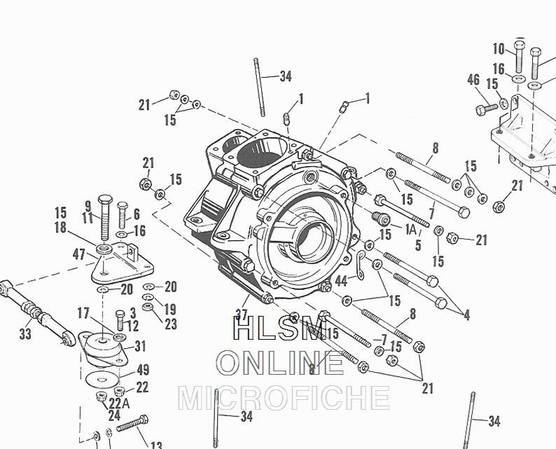

#44 in the pic, HD part number 45095-85.

This one look like it goes to 2 case bolts. As stated, not looking for trouble removing case bolts - if it was the nut side that would be better for me.
I think I will use the one that mounts to the engine mount if there are no objections........
So much for my overthinking this grade one situation..
Thanks again.

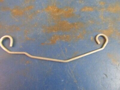

I could take a pic of the factory one on my bike if you're interested, but that's it. Wire thingie under the nut, presses down on the plug.

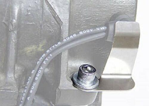

Always thought I was good at MacGyvering stuff, but I've had a headache for 24 hours trying to figure out how this style would mount
The one Hess showed is n/a from MoCo but available from all the usual suspects, +fleabay and NOS OEM can still be found. 45095-85
That case bolt only torques 15ft/lb so no worries about the removal but they need a flat washer under and another on top next to the hex. They will rotate as you torque so need to put it against the stater plug without the regulator boot on it, torque, then bend it outward to put the reg boot on, bend it back to position. You can bend them fairly easily for later removal etc, they won't break. They are by far the cleanest looking and easiest to clean around.

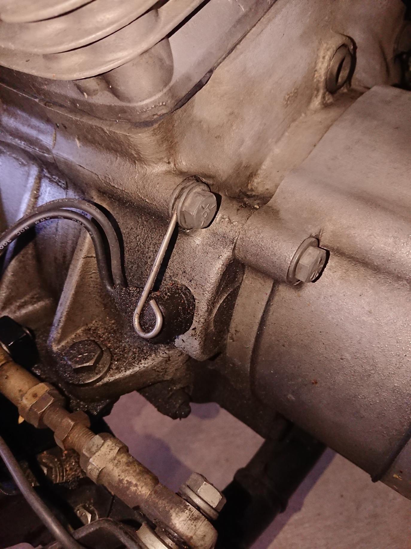

The top picture is from my mates '86 FXR.
Shows the OEM part installed.
The bottom picture is from the web.
Some aftermarket part installed.
