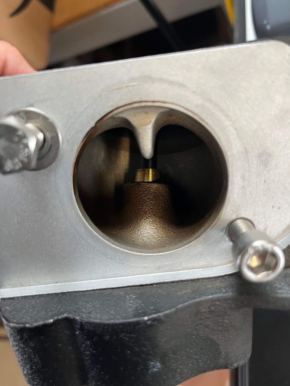

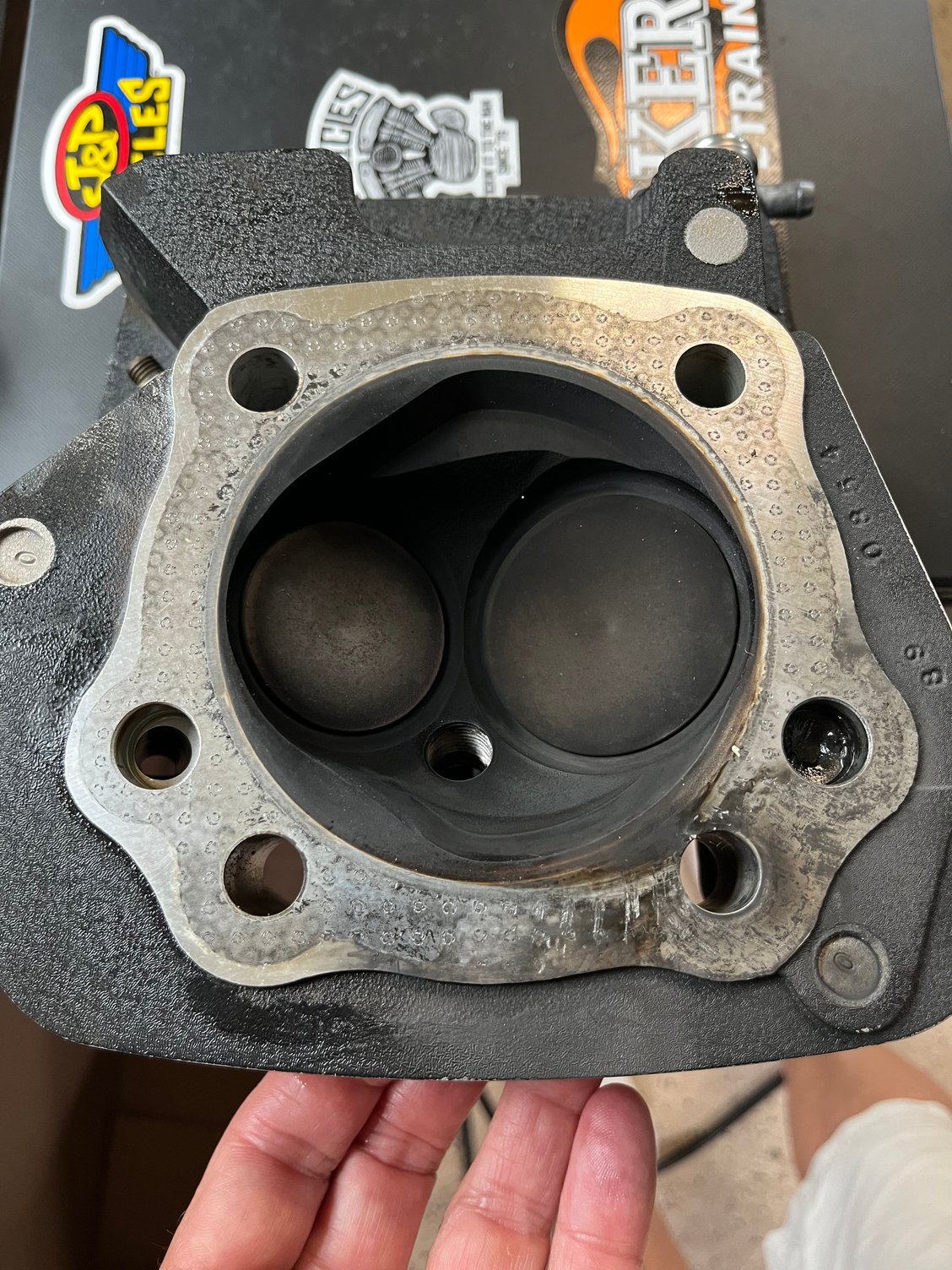

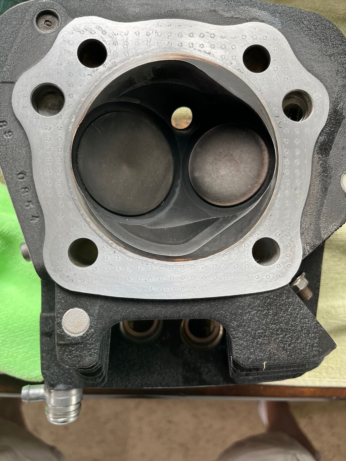

It wasn’t ported but cleaned up with new valves seated etc. Turns out I didn’t turn over a head and take a pic! Darnit. But I just did now…I’ve got to inspect that head where it blew. Pic looks like material missing…
Fresh out of the machine shop
Lower right is corner that blew. Haven’t started cleaning things up yet.
Intake on the head that blew the gasket

Whew! No material missing. Little brake clean on scotchbrite…gotta put this on back burner a few days. Wife had foot surgery yesterday and I’ll be helping her. Thanks for all the input

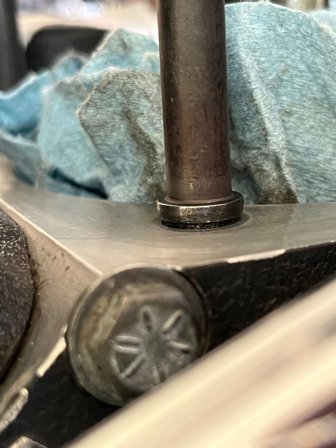

Bingo! That stud broke torque and red Locktite
Sooooo it will be Timeserted but should I do them all? 31 year old case, the machinist said he would sooooo no brained I guess.

Definitely need a little bit more information on this motor. You're saying it's 31 years old, so are you also saying that these are the original cases? The way you described everything I figured you had a replacement S&S V96" motor.. If these are the original cases then yeah you're going to need to timeser all the studs because 89 to 91 cases were prone to pulling studs... A little info goes a long way...
