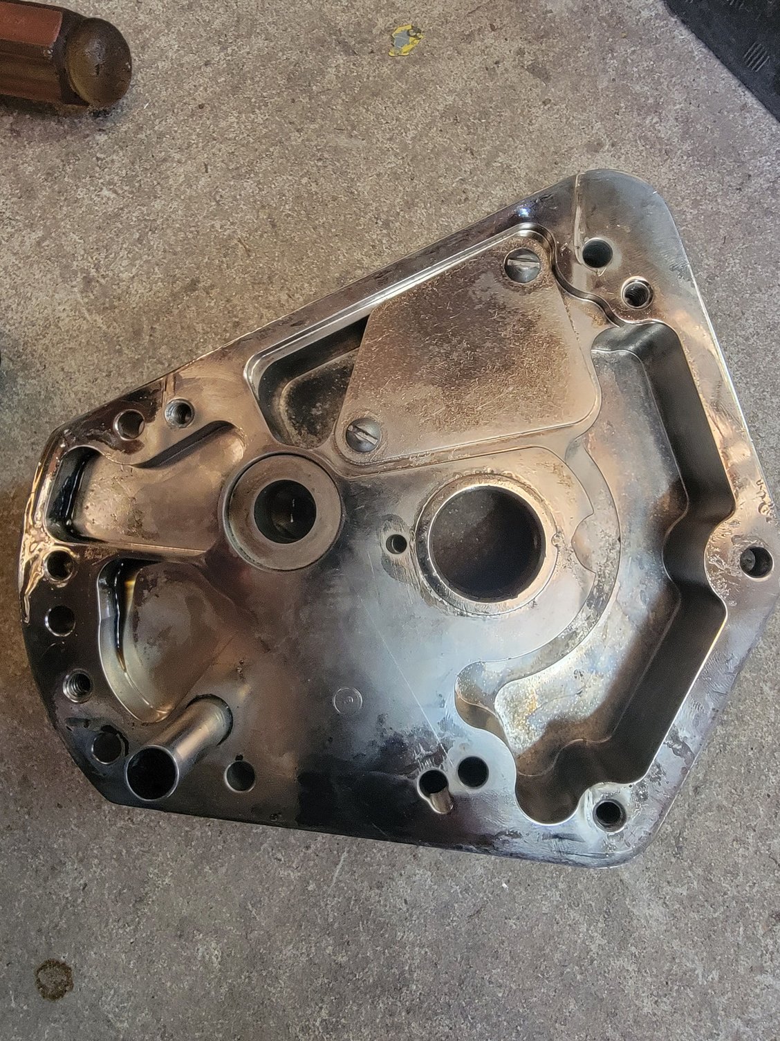

Cane you name this part

Cam cover.

Cam Cover ... Nose Cone

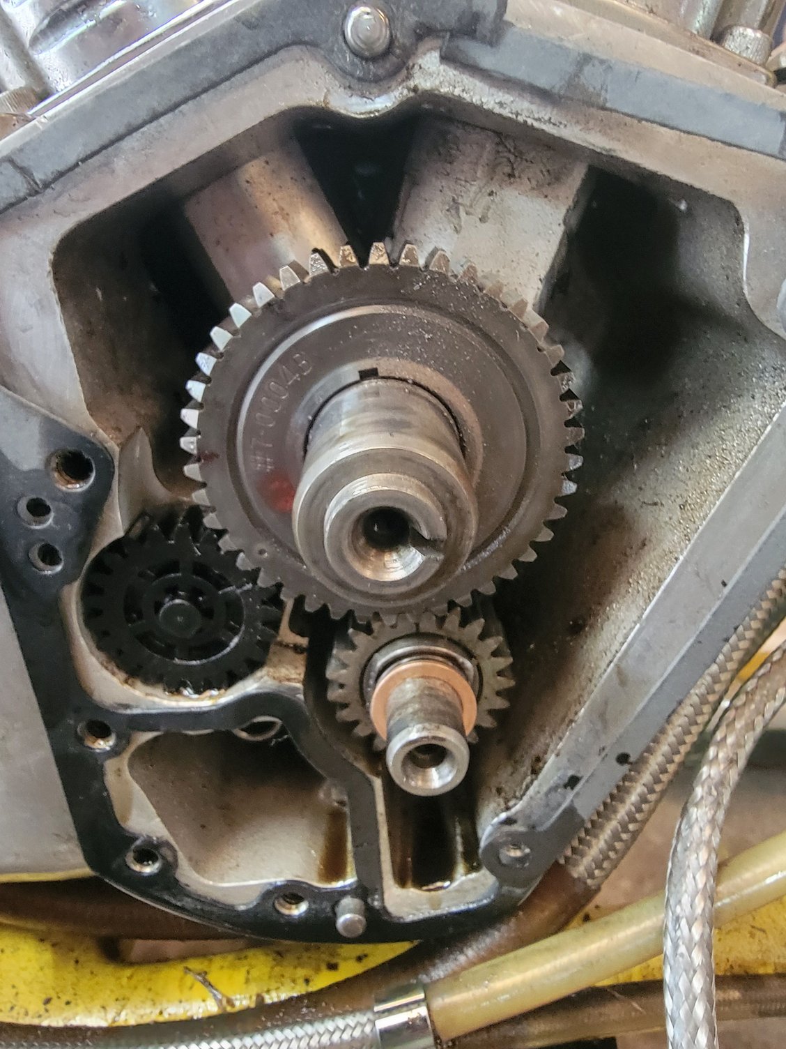

Originally Posted by Chilly1969willy@gmail.com
Cam chest gear cover in the first photo,
Second photo is cam gear cavity,
so Crane cam up top,
crank shaft with mating cam gear bottom (will be a another gear behind it that will drive the oil pump gear on it shaft that is coming in from the right), and the black plastic piece to the left if the breather valve; that is missing it's metal shim that goes between it and the cam chest cover plate on the breather gear center numb (check, but chance is dropped down and out when you pulled the cover..
Plastic shim for the plastic breather gear.
