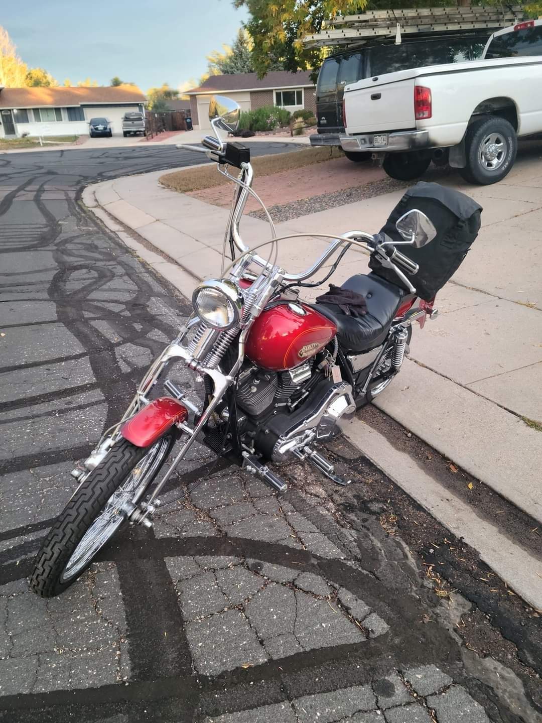

I came across this picture on Facebook. It looks a lot better than I had pictured in my head.
