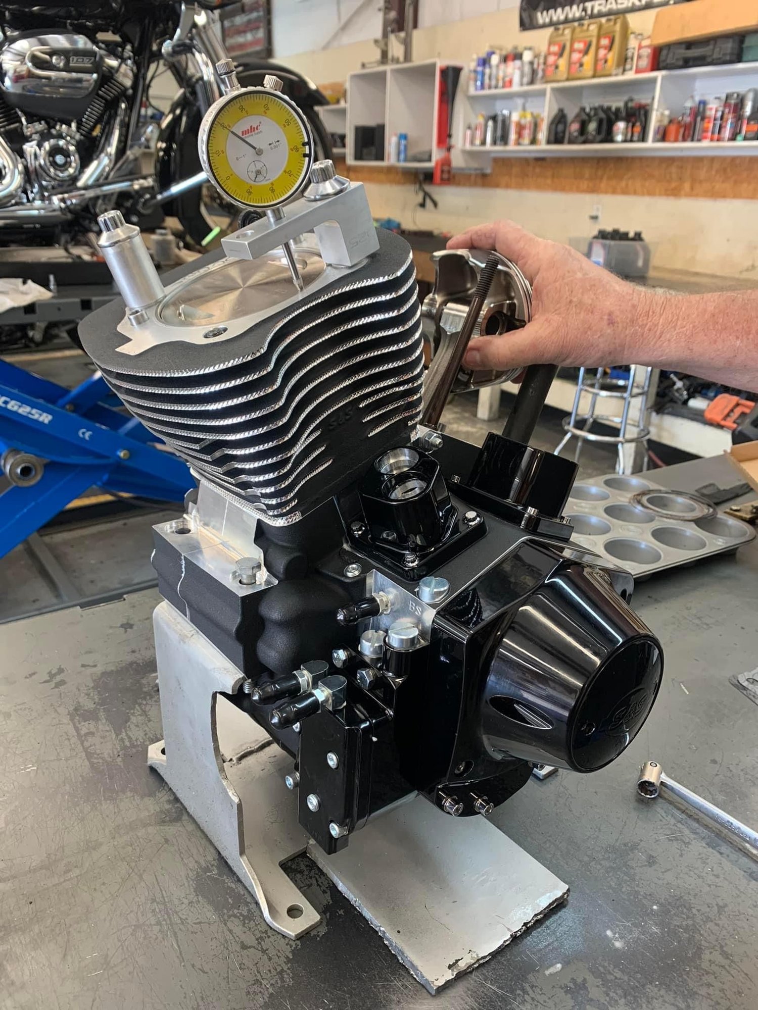

Got a few pics of engine I’m stuffing in the Springer
The first pic was this January when the new S&S 111’ was delivered
to my Indy.
During assembly:
Now keep in mind I had the heads & cylinders sent to California to be Diamond Cut.
Changed cam to a Reaper 543, & heads cc’d to keep a 9.2:1 corrected compression.
Bob Woods lifters, S&S Quickie push rods , Mikuni 42 carb , Arlen Ness / Stage 1 Big Sucka breather kit & a Trask 2 into 1 exhaust..
Other parts I’ll update on this thread as I go.

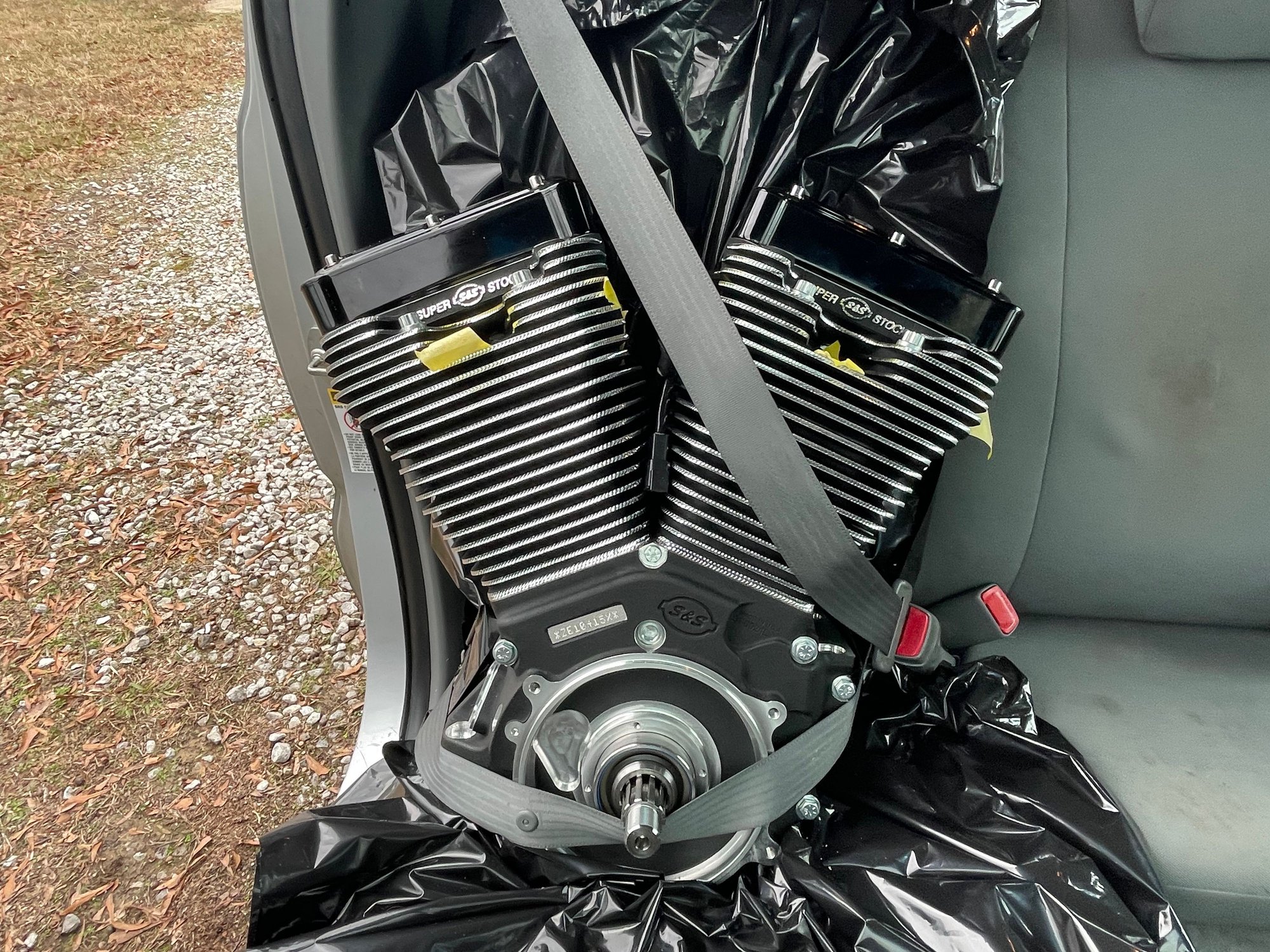

Finished product:
I buckle up all my loved & cherished loved ones , including my engine . 🤣
There are some who like to sneak their big inch motors in through the back door.
You see who wears the pants around my homestead! 😉
I bring em home in the front seat & announce, “ We’re Here !!!”.

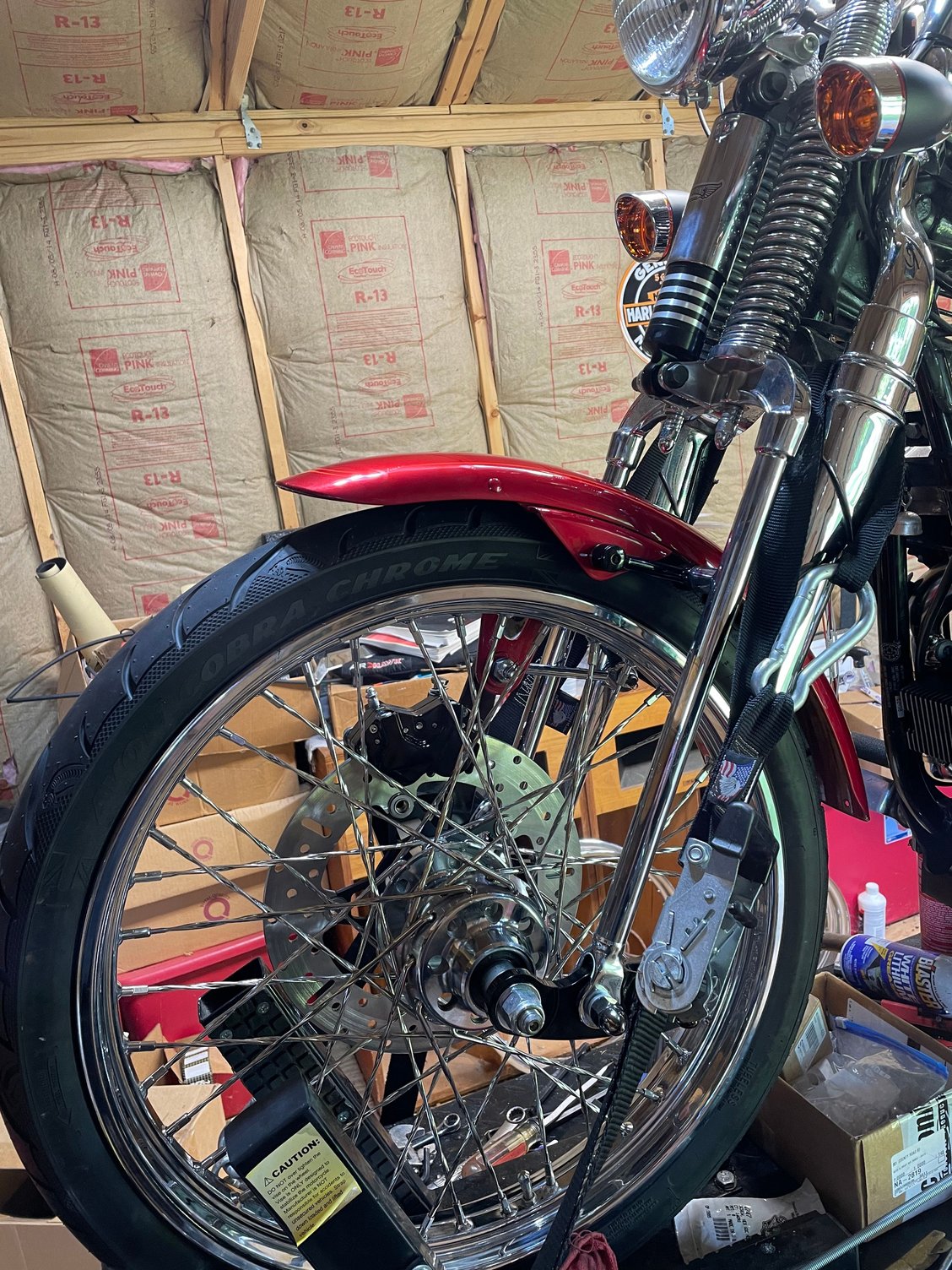

New PM calipers & bracket, Speed Dealer Custom Rockers ( lowers front end 1”)
EBC 5 button floating rotor, Buchanan Stainless Twisted polished spokes,
new oem rims , Fournales Front & rear shocks.
Relocated turn signals to forks & used black housings.
I plan to make as much of the bike black as I can.
