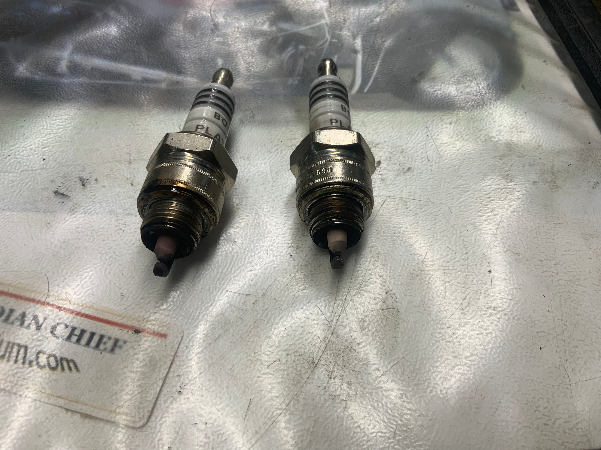

Sorry if I’ve left the wrong impression. This is a bored out G with an adjustable air bleed and no t-jet. You may be thinking from another thread where I mention I have a D that has T-Jets and I would like to remove them and try the D down the road to see if more power is there.
For now with the G bored out shaved throttle shaft, adjustable air bleed I’m running 32/84 and a 120 air bleed. Currently when the motors nice and warmed up around 200 degrees oil, the mix screw is between 1.5 and 1 7/8 out. With a 33 it was like half a turn out… meaning 32 is probably right.
Old Oct 31, 2023 | 04:14 PM
  #48
98hotrodfatboy's Avatar
98hotrodfatboy
Posts: 21,093
Likes: 7,619
From: Poolville
