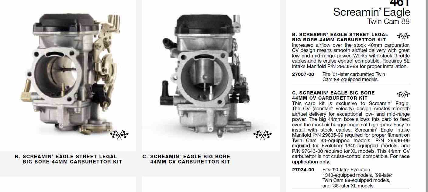

Originally Posted by SparkyD
Let's throw something else in the mix.
I like my CV40 carb because it's nice and smooth. I appreciate the performance of S&S carbs (had one on the shovelhead) but . . . if I drop the dough for an El Bruto 107" would a CV40 work? I've heard about early TC's coming with CV44's but I can't seem to find anything about a CV44 so they must not exist.
With a 107 I'd want a bigger carb than a 40. I guess it would work tho. I'd use a HSR45 Mik..
CV44s:
They pop up on fleebay.
https://www.ebay.com/itm/225800274684
Don't know if that one is for real, could be.. Number is a little different. 02 SE catalog.
Old Oct 19, 2023 | 09:44 AM
t150vej's Avatar
t150vej
Joined: Dec 2005
Posts: 5,403
Likes: 2,605
From: NC USA
That one on ebay is the older "street legal" version - discontinued. Current carb number is 27934-99 and $347.95 retail from a dealer.
