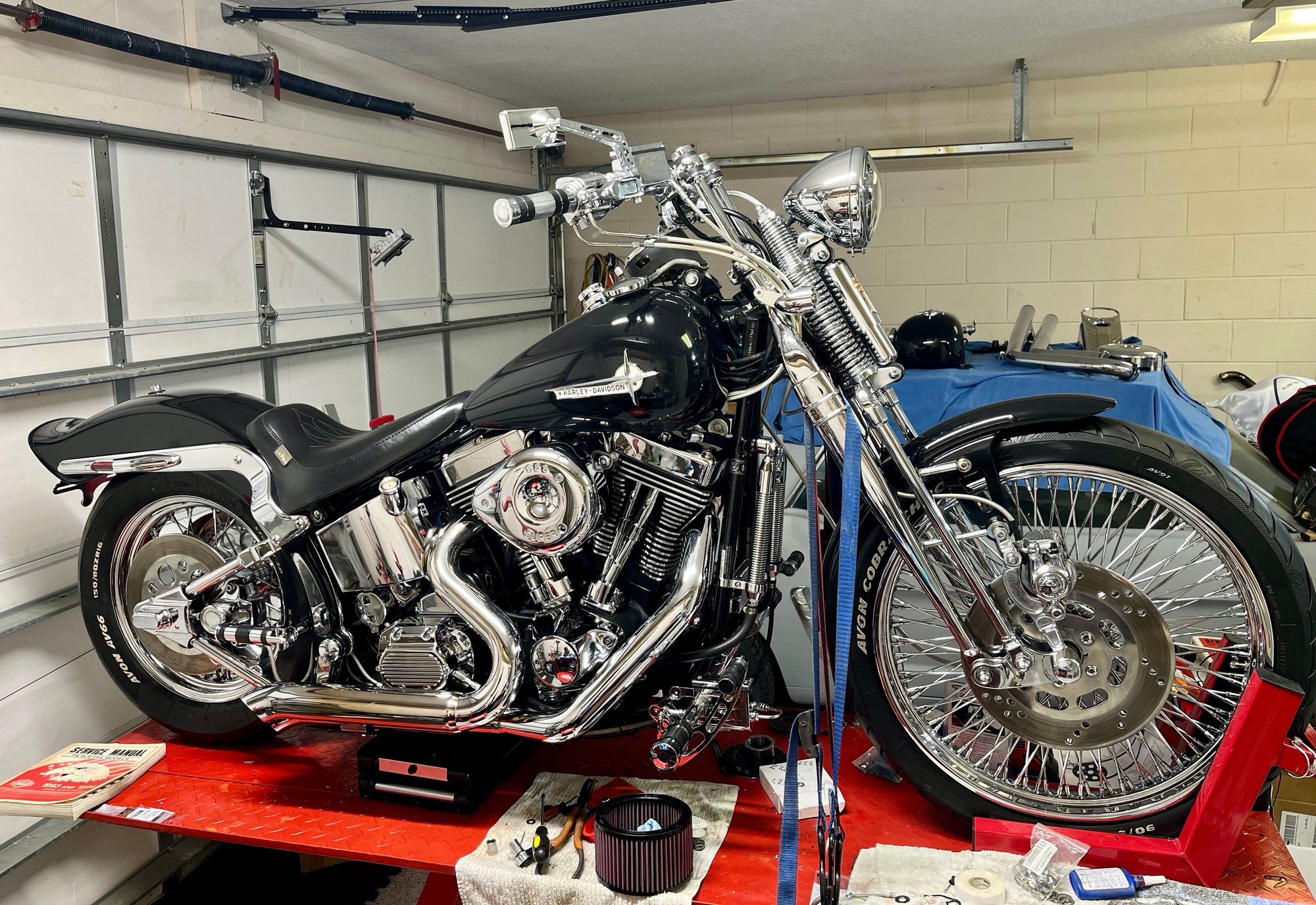

About 2011 or 2012 I assembled a 127 for a guy. The only thing we did different was lifters and a 3 angle valve job and he made the advertised hp easy. I moved and lost track, don’t know if he’s still street/strip but last I knew it was running great.
I just bought another un assembled 127 and blue printed it and installed it in my softail. I haven’t fired it yet but everything looked good. Next year I’ll replace the rockers and have the heads ported and a new valve job… but I’m pretty confident it will get me into the 10’s likely 140 square. I’m gonna run my bored out G carb and I have two sets of exhaust to try, Bassani pro-streets and hooker three step drags. After the 1000 mile break in I’ll do some track and dyno to see what’s up.
