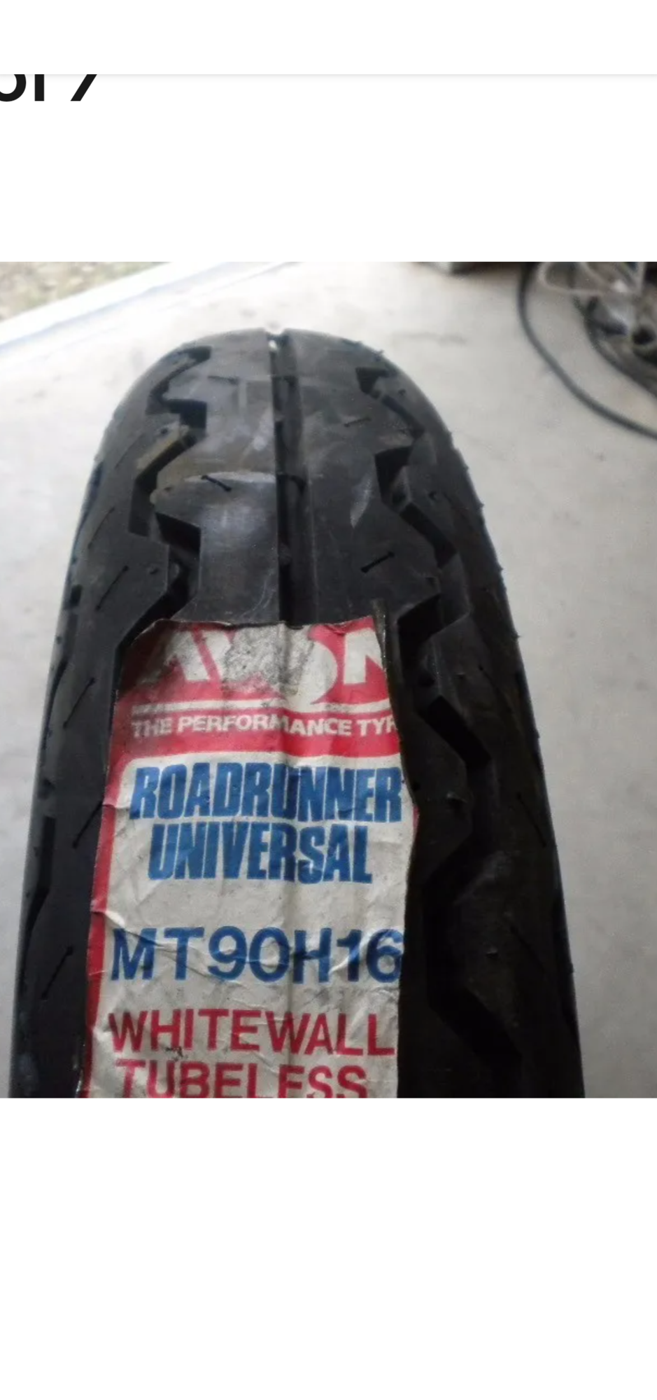

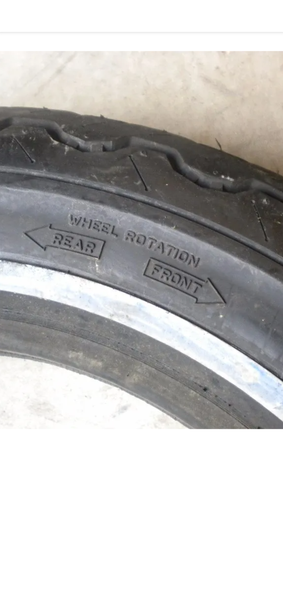

Avon used to make the Roadrunner Universal that you could mount on front or back. I used them on my Electric Glide, used the same size front and rear, 130/90-16.
I wouldn't use them now. Today's tires are much more advanced.
