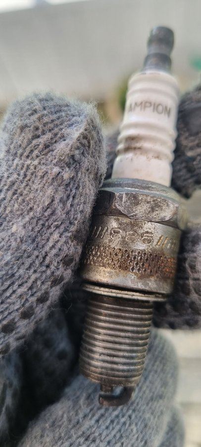

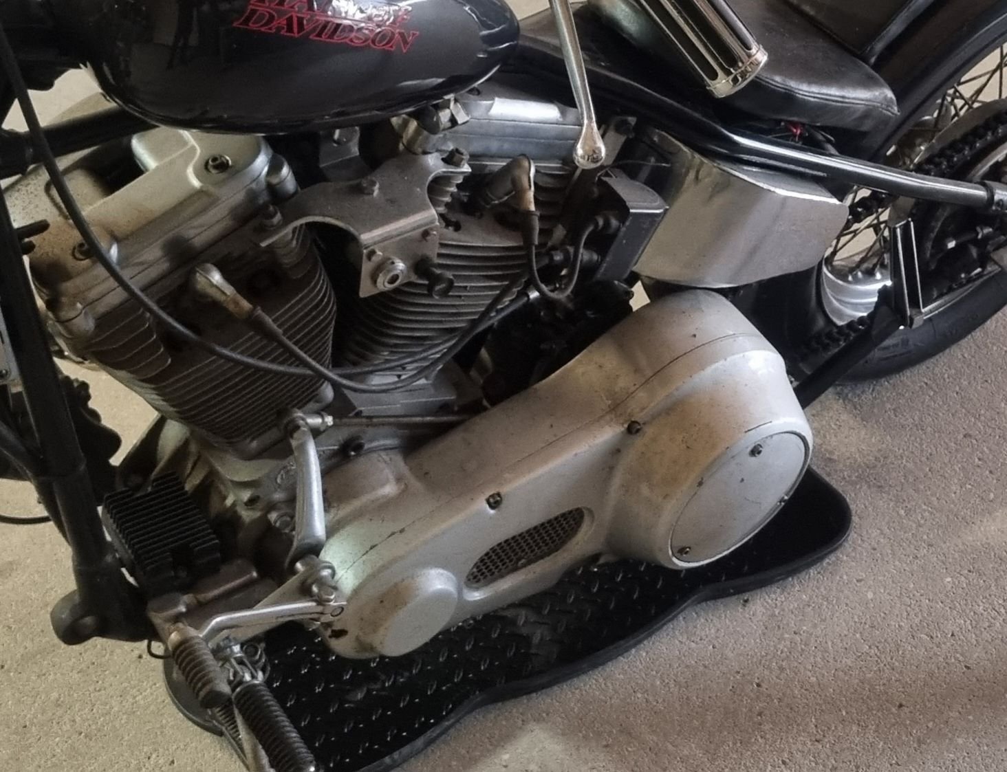

From you’re explain my guess the timing if off - you need to take some pictures
what is in the cone r/s lower engine 2 screws or Allen’s usually photo what is in it so i know what ignition trigger it has
picture up both sides of the machine so i see what your dealing with in a visual - what carb if its hidden in pictures possible its an S&S super e
pictures up the plugs also — and yellow spark is actuall ok for this
Thanks for the responses.
im not sure what kind of carbs, maby you can see it ?
These are the only pictures I got right now .
I hope it helps .
